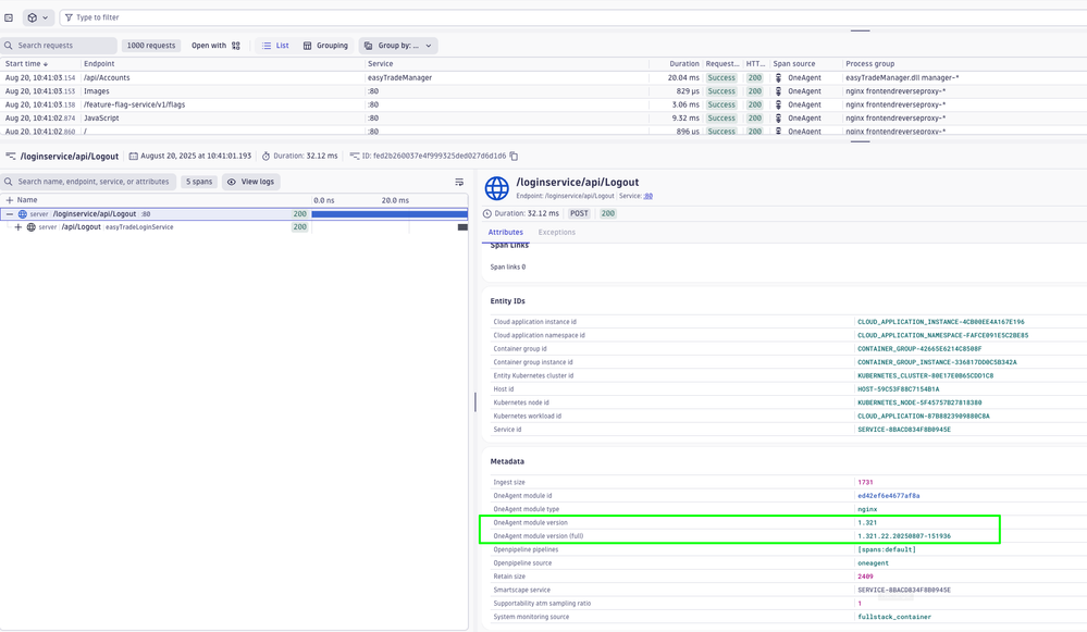

  • Check the Dynatrace OneAgent version. If possible, always use the latest version. You can verify the OneAgent version in the trace by looking at the attributes.

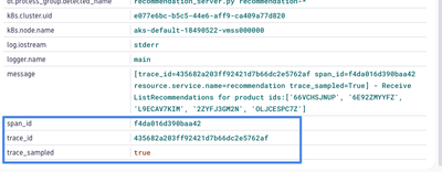

  • The enriched logs should have dt.span_id, dt.trace_id, dt.trace_sampled fields, below is an example of a sample log file. Note that  if dt.trace_sampled= false implies that the trace related to that log was hit by ATM, and as such, that specific trace won't be available.
