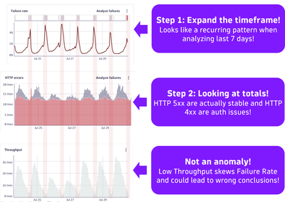

In my exploration I analyzed the last 7 days and its easy to see that this is a daily recurring pattern:
Analyzing 7 days, 30 days, 365 days help us see whether there is some recurrence going on here!

In my exploration I found that the 5xx errors were rather flat and I just saw some increase of the 4xx (client authorization issues). Those however didn't really spike - looks more like a bump in the road:
Its always important to understand what results into a failure. For web requests its good practice to analyze your HTTP Status Codes

In my exploration I looked at the throughput which shows that we have a very obvious traffic pattern which shows higher traffic during the day, low during the night and overall only about half the traffic over the weekend. And if we put all those pieces together we can see that the failure spike is not an anomaly - and - its also not a problem on its own as it gets impacted by traffic and the way we define what an error is:
Its important to analyze the relationship between metrics to understand the full context to make good conclusions!

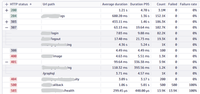

1: Clearly define what is an error that needs your attention (HTTP 5xx) and what is just noise (some of the HTTP 4xx)
Getting an overview of all HTTP Status Codes per Endpoint is a good way to start to see which error codes are really important or not. This allows us to fine tune the failure rate calculation.
We can do a detailed analysis of every HTTP Status code and see which ones should really be considered an error / failure

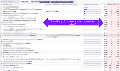

Also keep in mind that besides looking at HTTP Status codes you might also want to look into Exceptions and consider requests with critical exceptions as failures even though they may not result in an erroneous HTTP Status Code.
Exceptions are good indicators for critical errors – but – they are not always propagated back to the end user as an error.
Another interesting finding was that all those 503 requests actually came from the same source - which was the AWS Route53 Health Check Service. We can easily identify this by grouping distributed traces by HTTP Status and User Agent.
Closer analysis reveals that >90% of those HTTP 503 were caused by the Route53 Health Check Service
We should also follow up here and exclude those from the regular alerting definition and also follow up with AWS to see why those checks are made and how they can end up making that many calls that lead to errors. In the User Agent String there is actually a URL encoded that allows someone to report unexpected Health Checks!

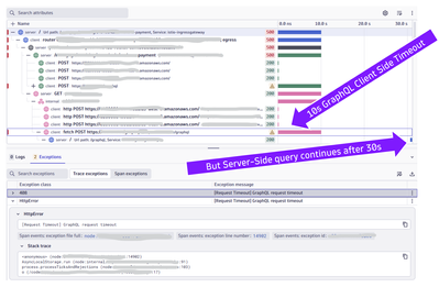

First I wanted to know what is causing those HTTP 500 from the "real users" (excluding the AWS Route Health Checks). Looking at some of the traces I could spot problems with backend GraphQL queries that timed out. The traces show the actual API Call to fetch data from a backend service that closes the TCP connection after 10s and therefore results in the HTTP 500 to the end user! What is really strange is that the GraphQL query on the server-side continues after about 30s. This is clearly an issue to look into!
Distributed Traces show us the real root cause of some of those HTTP 500s - like GraphQL Query Timeouts

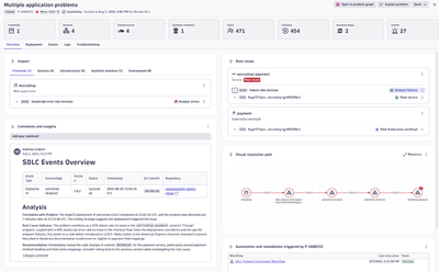

I leave you with the following Dynatrace problem ticket that you can also explore yourself on the Dynatrace Playground. (don't have access to playground - just sign up here). It really shows how Dynatrace detect abnormal behavior, provides root cause insights and even provides suggestions about which CI/CD deployment or Pull Request most likely caused the issue. And of course - these insights can also be used by your human and AI SREs to speed up mitigation of issues 🙂
Dynatrace Intelligence automates the detection of anomalies, root cause and can also automate remediation
