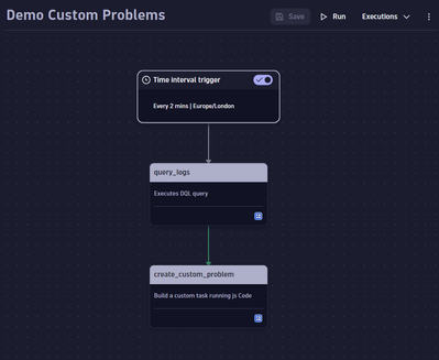

03 Jan 2024 04:26 PM
Hi @y_buccellato ,
I believe yes you can do this with the workflows capabilities inside of Dynatrace. You could have a timer that executes the workflow every x minutes depending on the frequency of how many times the log is written two.
The next step would be creating the DQL query you are looking for and passing the output of it to the next step.
The final step would be a Javascript "node" that would execute the Problems API internally from the workflow to create a custom problem , here you can do some data transformation to select the data you want out of the DQL query results and add it to the body of the problem.
All being well it should look somthing like this:
In addition if you dont get the data out of the DQL "Node" you can allways also query the DQL API from Javascript aswell so you would just have 1 JS "node" that queries , processes and posts a Dynatrace problem.
