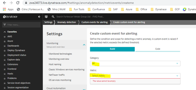

what's your metric ?
Queue depth.

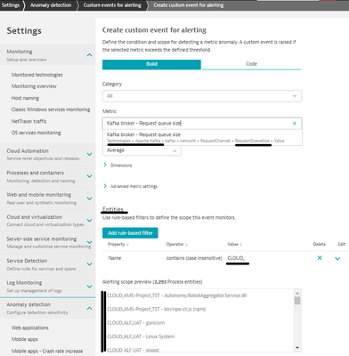

I'm unable to follow. As far as I know, there is no queue depth metric, as in, 'Queue Depth'.
Sample metric is : builtin:tech.kafka.kafka.network.RequestChannel.RequestQueueSize.Value
Can you take a screenshot and show me the queuedepth metric you are referring to?
Another Sample, for you, if I go ahead with the below Configuration, the Custom_Alert will be a catch_all for "Queue Depth"  across  all services/queues/dimensions with by the names like "CLOUD_"

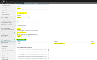

It seems I was not clear in my message that I am referring to the IBM MQ monitoring through the extension.

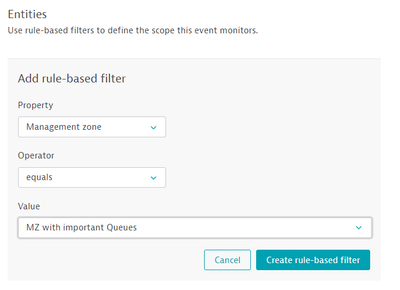

Sure. Go ahead and create a "rule based filter" and chose the "Name" as the Entity and look for 'case (insensitive)' and value be your 'filter string' expression "RICH_".
See the sample below:
This configuration will take up to the queue manager level but not to the individual queue levels.
e.g. a queue manager can have several types of queues but we are interested to alert on a few of them when the queue depth will reach a certain limit.

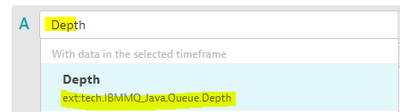

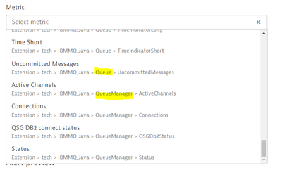

Hi @Babar_Qayyum,

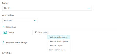

you are almost there, the specific metric you want is indeed ext:tech.IBMMQ_Java.Queue.Depth
That metric will have the different queues as dimensions, which you can select on which one to alert on a desired depth.
This is a metrics based off the queues, you can identify this in the metric key, from left to right like a drop down ext:tech.IBMMQ_Java.Queue.Depth
You can identify on which entity the metric is based (dimension) by looking at the highlighted section below
Best,
Mark

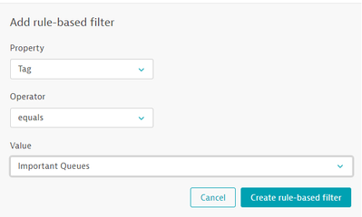

You can add the desired queues to a specific management zone
Or tag all important queues

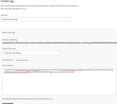

You can tag (or by this means also use the following rule in a management zone) e.g. using properties/tags of the underlying process groups of the queues with following selector
type(QUEUE),toRelationships.isInstanceOf(type(QUEUE_INSTANCE),fromRelationships.runsOn(type(PROCESS_GROUP_INSTANCE),fromRelationships.isInstanceOf(type(PROCESS_GROUP),tag("some_key:some_value"))))
Exactly. I am looking for the same. How to tag individual queues?
Using the Entity Selector you can tag individual or multiple queues at the same time, will depend on the selector
For now the value given in the selector is a static value, i.e. you will need to manually define this for each individual rule in the auto-tag.

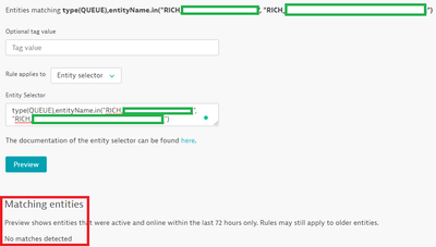

You will need an entity selector, what you pasted in the box is a metric query.
I think a selector like this one could work for you:
type(QUEUE),entityName("RICH_BMC_Notification_Req")

yes you can with e.g. following selector
type(QUEUE),entityName.in("RICH_BMC_Notification_Req", "some_other_queue_name")
Hello @mark_bley
No matching entity with this configuration.
Regards,
Babar
The names need match exactly what is shown as the display name for each queue.
If it worked before for one it should still be showing at least that one in the preview, make sure you are copying exactly the display name.
