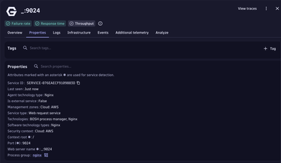

It looks like Dynatrace can’t detect a specific technology (such as Spring, PHP, etc.), so instead it falls back to naming the service as “Service + port number”. In such cases, your failure detection rule may not work as expected, because the rule depends on how the service is identified. If you’re trying to filter out certain 500 responses (which I understand is the goal), the mismatch in service naming could be the reason it isn’t applied.
Could you share a bit more info about the setup? For example:
  • Do you have deep monitoring enabled, or only basic process monitoring?
  • What’s the underlying technology (Java, .NET, PHP, Node.js, …)?
  • What do you see in the Properties tab of the service?
That information can help decide the best way to configure failure detection. Sometimes it’s better to use service naming rules to give these services more meaningful and stable names.
Here’s an example from a demo environment: the service name initially looks “strange,” but when we check its properties, we can clearly see what it really represents.
Dynatrace Integration Engineer at CodeAttest
