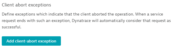

If you're primarily just concerned with the ignoring the exception even when a 500 is returned you can do this by marking it as a client abort exception instead of just as an ignored exception. This takes precedence over HTTP response codes:
Looks like that should work, thanks James!
Yes, this works like a charm in our case 🙂
