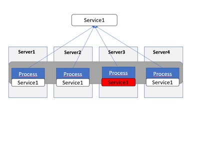

Our situation and need is little bit different since we are trying to avoid the case where every server would have it's own process group and therefore each service would be split per server basis.
So our case is that each service (and therefore each process group) contains multiple different instances which are running the same service.
The problematic part is that we would need to provide the information automatically if the Service1 is facing the problem on server3 so we could operate it automatically. Currently we are just getting the information out that the problem happens on Service1 without straight indication that the problem is happening only on one server instance.
We are currently playing around with the topic that can we pull out automatically somehow from Dynatrace that which server instance we would need to operate or should we just utilize some other event source than Dynatrace in our case.
