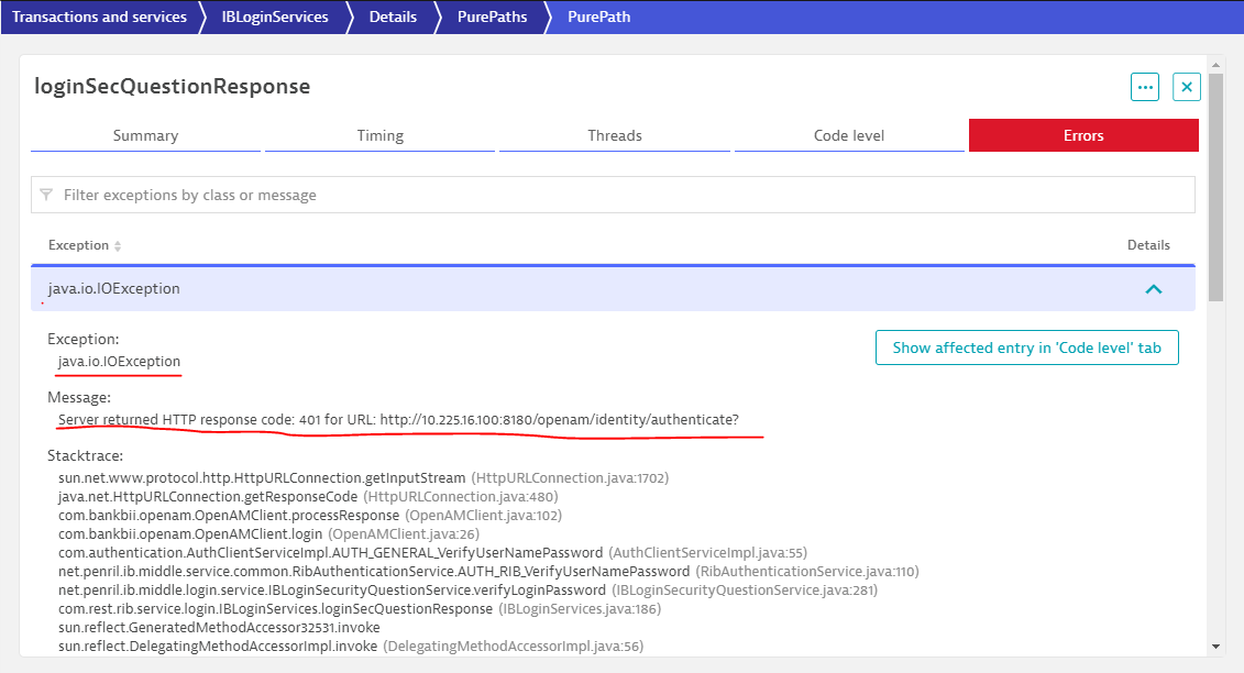

Hi Expert
I would like to create an alert based on particular exception within request like below capture. Example, if this exception occur 10 times in 5 minutes, Dynatrace will send the alert.
But I don't know how to create alert based on particular exception like this in Dynatrace Managed, as I know in AppMon is very simple and easy to create this case.
Anybody can give me idea to create this case ?

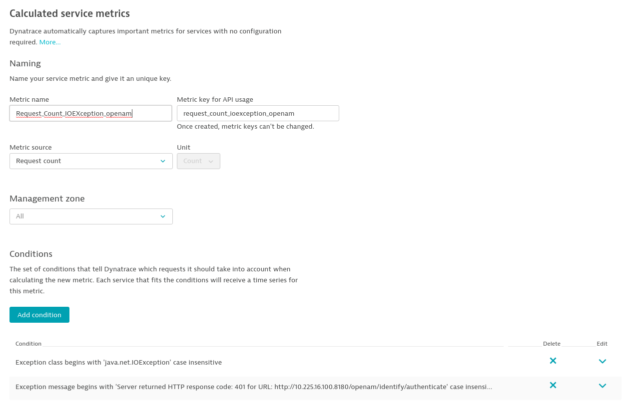

Hi Julius,
Can you give me a sample on the first approach ? I still don't understand "define a calculated service metric that will be a count of requests having that particular exception "
In Settings -> Server side monitoring -> Calculated service metrics, I'd define something like this:
You might want to define additional conditions such as tags or process groups. This will create a new metric representing number of requests having hit particular exception with the exception message and you can alert based on this metric.
However, since your example is just about IOException, I'd recommend maybe reconsider monitoring that particular endpoint (either with OneAgent or if it's unmonitored host, then by creating a custom device) and not alert on such generic exception.
