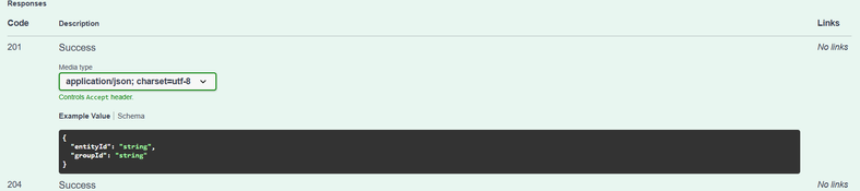

  1. As long as, the hosts aren't monitored within the monitoring tenant, you can create custom devices through the Rest Api or the UI as well both are applicable based on your preferences and the best suitable for your team.

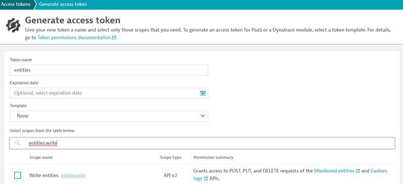

  2. To create custom devices through Rest Api, create access token with "entities.wite" and use it to create a custom device through Environment APi v2 or the curl command as per preferences.

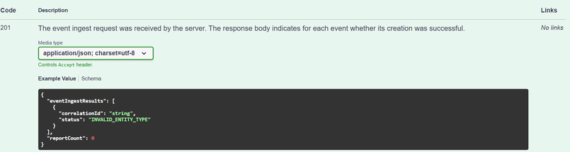

  3. Create access token with "events.ingest" to utilize it while using the API to ingest events into the custom devices.
Then Execute > upon successful execution > you should receive one of the below Response codes.

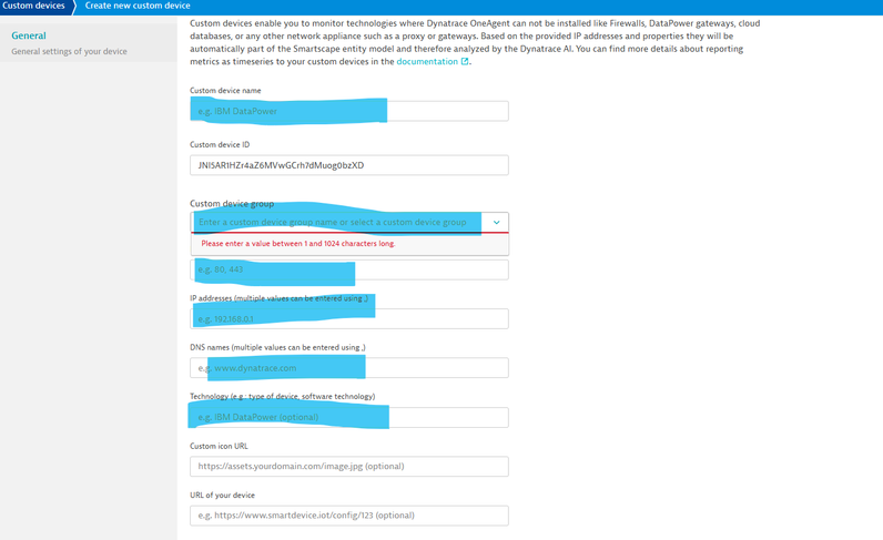

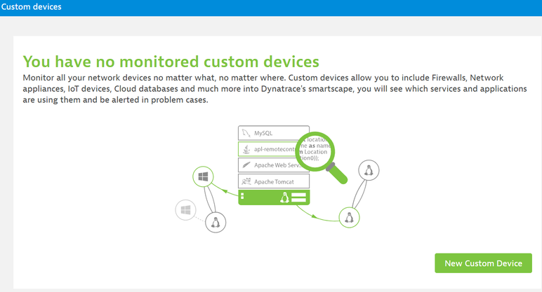

To create custom device through UI
Under Infrastructure Observability > Technologies and processes > Custom Devices

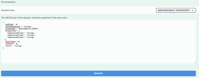

After that proceed with Events ingestion through Environment Api v2, just an example, you can customize as per actual requirements:
  • you can utilize rest Api externally to create custom devices and ingest events as well without need to access the UI through the generated Curl command from the monitoring tenant.

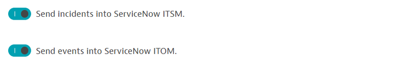

You have options to either:
  • Continue with current integration with ServiceNow to keep posting notifications to SNow URL.
  • Enable the below options in Dynatrace integration side
For event Integration
So, all events will be correlated to the impacted entities, you will be notified in case of any impact or issues.
Or
You can configure CMDB integration between Dynatrace and Service Now it will figure out a comprehensive monitoring and integration Landscape.

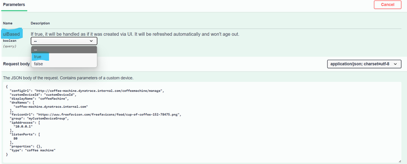

Please evaluate te script here below. The cutome device is added but no events are accepted (reportCount 0):
#!/bin/bash
# set -x
CiTkn="Token1"
CrtTkn="Token2"
# Add Custom Device
curl -k -X 'POST' \
  "https://10.224.73.9/e/9b3c1c96-fbed-4434-b713-c063b98ba1d7/api/v2/entities/custom?uiBased=true" \
  -H 'accept: application/json; charset=utf-8' \
  -H "Authorization: Api-Token ${CiTkn}" \
  -H 'Content-Type: application/json; charset=utf-8' \
  -d '{
  "configUrl": "",
  "customDeviceId": "v5060mgt1234",
  "displayName": "Router1234",
  "dnsNames": [
    "v5060mgt1234.grit-ot.nl"
  "group": "myCustomDeviceGroup",
  "ipAddresses": [
    "10.224.73.123"
  "listenPorts": [
    80
  "properties": {},
  "type": "Router"

Event when creating the CI (Host) the ingest of a related event does not work. I made a shell script that first adds the CI to the Dynatrace environment (Works and is seen in DynaTrace) but an event for this host gets reportCount 0. When I use the same event to for an existing host (that have an OneAgent installed). it does work. See the reply with my script for the used API's
