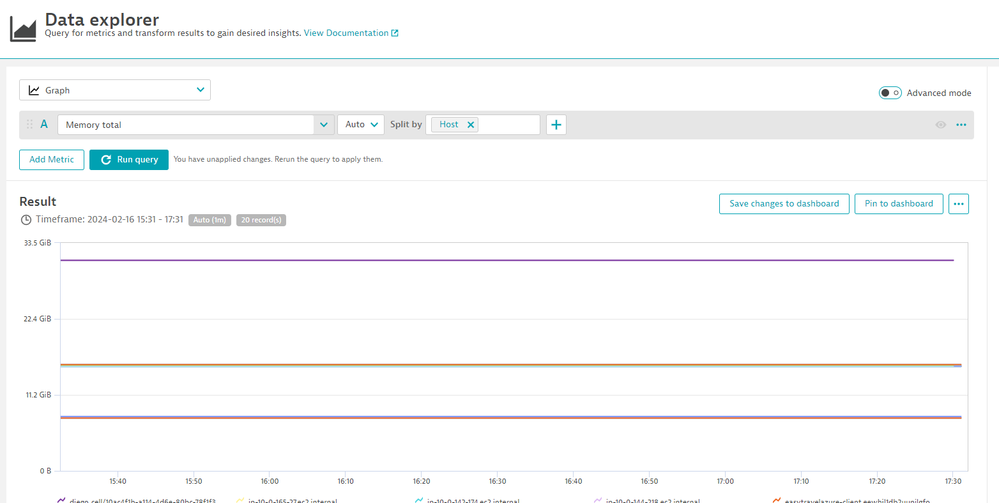

You can easily find them using the delta transformation in Data Explorer:
builtin:host.mem.total:splitBy("dt.entity.host"):auto:delta:filter(series(auto,gt(0)))
like this?
i think this dashboard gives me host memories. but it does not give me alerts if hosts' memory sizes change or cross the limits i can create.
i am still confused how can i create alert on this dashboard.
Please paste the metric selector I provided into advanced mode. :delta transformation is the important point.

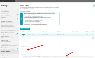

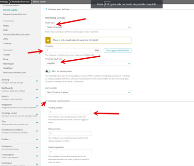

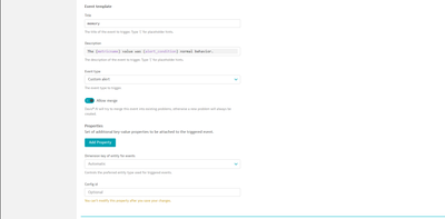

You can create a "Metric Event" for it. Select an appropriate Event type, and then alert on it.
Antonio Sousa
@kasdev , to create the metric event, you can use the following fields
