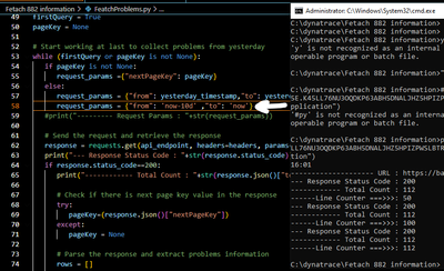

Iam getting certificate error "urllib3.exceptions.SSLError: [SSL: CERTIFICATE_VERIFY_FAILED] certificate verify failed: self signed certificate in certificate chain (_ssl.c:1007).
Please check attach output.
16 Nov 2023 11:36 AM
I used verify=true in "requests.get" and certificate error is fixed now but script is not getting completed just its keep on running in loop.
PFA snapshot.
16 Nov 2023 01:56 PM - edited 16 Nov 2023 03:09 PM
Hi @gurugogi
My bad, gave you a not complete code ..... try the attached one see if its works for you
Just tried that with 10 days and its look like its working
Yos
