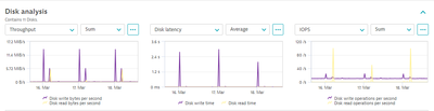

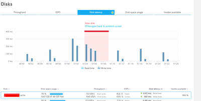

I am trying to understand what might be causing some slow disk problems on a monitored host. We can see that latency shoots up in intervals of 5 minutes, and sometimes reaches 300ms+

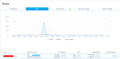

Just before that, we can see the throughput go up, but not a ton of data is being written:
From the IOPS metrics, we can see after writes/s go up, so does the queue length:
