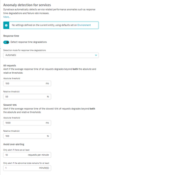

I want to stop alerting for a specific requests (for a specific service).
All GET requests should not alert.
I know that I can mute the requests, but with the mute I will skip the statistics (response time, failures...).
So, to resume, I want to keep all the KPI and statistics, the only thing is to not alert.

A workaround you can do is maybe mark the important requests you want to alert on as key requests. You can then turn off response time degradation and failure rate detection for the service but turn it on for your key requests

Yes I was thinking for that but it will take a huge time because the number of requests is too high.
I found the temporary solution which is to group that requests and mute them.
Its working fine right now, let see.
