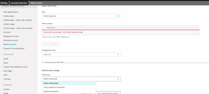

I am tasked with the creation of a custom alert for a specific API, wherein I want to set the alert based on this:
1. should have auto-adaptive threshold
2. For each time frame, the past week's traffic data should be reviewed, identify the highest traffic value, and set the alert threshold 25% above that maximum.
I have configured a alert, wherein i am to able to set the threshold using static threshold only, but this does not solve my use case. I even created a calculate service metric but still i can set only static thresholds.

Hi @mehakpuri01
I thnik you can use auto-adaptive threshold only with metric selector type. Create your metric expression from your metric in the Data explorer advance mode.
