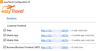

So, you should be able to set the IP address in the easyTravelConfig.properties file.
Look for the entry config.apacheWebServerHost for the Apache component - change localhost to your public IP and see if that works if you start the UEM -> Standard scenario up. It works for my setup on Windows, changing localhost to my local IP address, so I don't see why it won't work using a public IP, granted the correct firewall rules are in place, of course for remote access 🙂
I also updated localhost for the config.apacheWebServerB2bHost entry to my local IP address.
Let me know if the changes work for you.

Hi @Ken-K, the app detection rule should be set up to look for traffic on port 8079, not 8094. Have you tried changing the rule to look for traffic on port 8079? If the script is showing, it should work.
By 8094 I mean the weblauncher UI 🙂
_davidemascolo
Contributor
Hi @andre_vdveen , great! This solved my issue.
