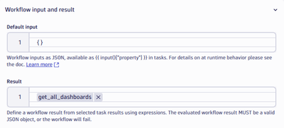

Hey all, I am following up on this thread. I am working on creating a workflow that automatically queries the Dynatrace Dashboards API. That will get a list of dashboards and their respective IDs. I want to then take it and get all the dashboard JSON files to then upload them to gitlab.
I am currently getting the full list of dashboards, but I am having trouble taking that "dashboards.json" file and passing it to the next task. I have uploaded the json in the result in the following task. I have added a screenshot here. Let me know if anyone else has tried to do this!
