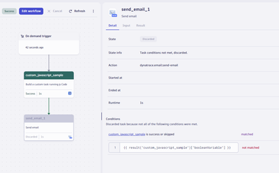

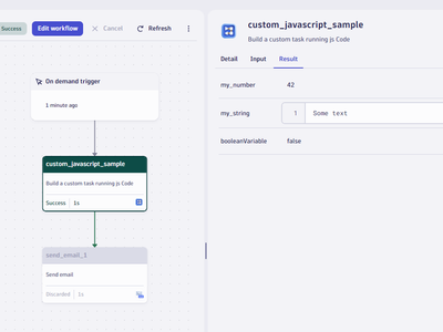

in order to make data available as the result of a javascript task, you can return the object.
Example:
export default async function ({ execution_id }) {
  // your code goes here
  return {
    my_string: "Some text",
    my_number: 42,
    booleanVariable: false
In case of checking a booelan variable, the condition check can be as simple as this
{{ result("custom_javascript_sample")["booleanVariable"] }}

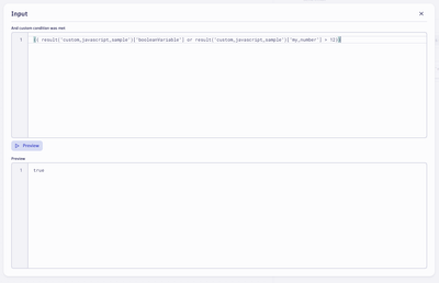

or a combination
{{ result("custom_javascript_sample")["booleanVariable"] or result("custom_javascript_sample")["my_number"] > 12}}
