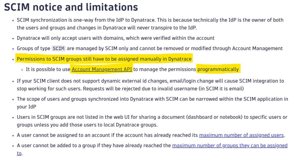

Hi @t_pawlak,
Definetely it seems it's not possible manage permissions using Monaco, even manage policies and boundaries or assign them to existing SCIM groups, according to this link:
Fortunately, automation via API is possible.
Thank you so much for your help.
