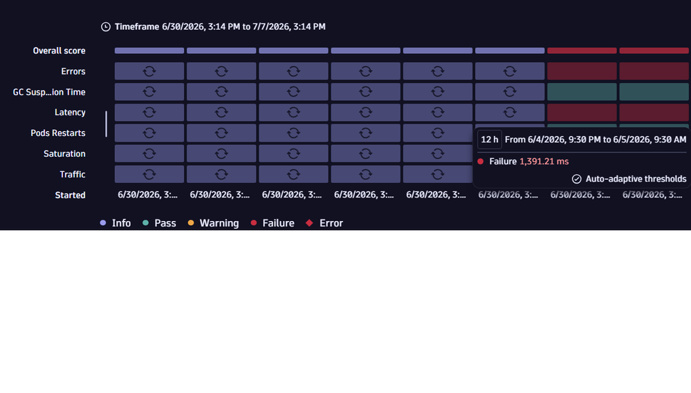

Hi Team,
I need help to understand how Dynatrace Site Reliability Guardian works, because i have created some guardian in Dynatrace but they are failing when there is slight change in metric values.
And the threshold definition is Auto-adaptive Threshold
first five run's results are [711.73ms, 711.73ms, 1321.07ms, 1321.07ms, 1370.06ms, 1370.06ms] and it's failed for 1391.21ms

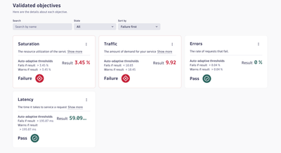

You can view the thresholds by scrolling down on the analysis page.dylan_taelemans_0-1783418052931.png
It will use the values of last 5 runs to create those auto-adaptive thresholds.
Personally, I recently started migrating (still in progress) all auto-adaptive thresholds to static thresholds in my SRG. I’m not a big fan of relying solely on auto-adaptive thresholds, as they often don’t align with what I actually want and don't allow any specific configuration or fine-tuning. (For example, as shown in the screenshot, the warning and error thresholds are either identical or have such a small difference that it doesn’t make a meaningful impact.)
I agree with this. It looks like in this case Auto-adaptive Threshold isn't the best choice.
Based on the results shown:
711 ms, 711 ms, 1321 ms, 1321 ms, 1370 ms, 1370 ms
Guardian built its baseline from a very small and rather unstable sample. As a result, 1391 ms (only about 20 ms higher than the previous value) can already be considered a threshold violation, even though it doesn't look like a meaningful performance degradation.
For latency checks, I would probably prefer static thresholds based on the application's SLO/SLA rather than relying solely on auto-adaptive thresholds.
