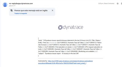

Hello, I have this workflow that runs every 5 minutes.
The first task is to perform a DQL query to retrieve the issues that have been active in the last 24 hours.The second task is to transform the JSON response into a table that is understandable and can be sent by email.This is where it fails.I've attached the workflow so you can guide me on how to send the results by email in a table format.
Thank you.

Hola
el resultado del correo se ve asi
Hello @AntonioLara!
Yeah, because you're using the whole json object... you need to use only the Markdown part, so access the "body" and return the value (the markdown itself), you should be good to go. Let me know if it worked. P.s: If it helped you, please Kudo my replies, I'm aiming to be member of the month 😁

Is it possible to view this in a more understandable table format?
