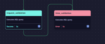

Hello everyone, maybe you can guide me. I have a problem. I don't know how I can call the data that two dql code tasks return to me, whether to use it in another dql or javascript task. I've tried using regular expressions, but I can't figure out how to integrate them into code. DQL from a previous task.
For example, the time_validation task returns the hour parameter that I need to use for aggregations in a new task with dql or javascript

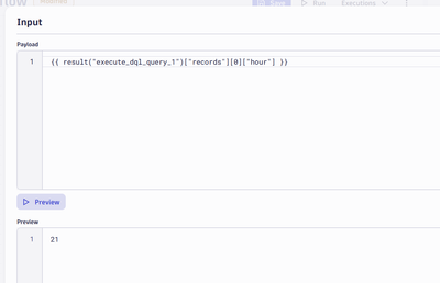

You can access task result data in other tasks using expressions, specifically the result expression https://docs.dynatrace.com/docs/shortlink/automation-workflow-expression-reference#result
In your example, you have a task "time_validation" with a result: records[{hour: 21, even....} .. ]
So in order to access the property hour in the first item of the records list, the expression would be
{{ result("execute_dql_query_1")["records"][0]["hour"] }}

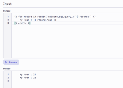

Given that the DQL query records are always a list, you might want to loop over them and grab the hour, for example
{% for record in result("execute_dql_query_1")["records"] %}
	My Hour : {{ record.hour }}
{% endfor %}

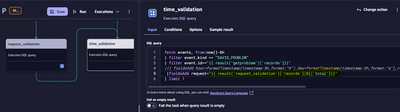

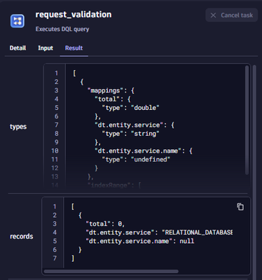

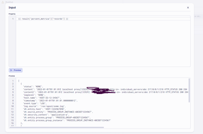

Thank you for your answer, however it gives me an error when calling the result of the previous task as proof I am calling the total value of the previous task "request_validation" as seen in the image, the error log tells me that the variable does not exist
the expression looks good. Can you share the exact error message?
Also to make sure the tasks have a dependency with each other, can you share the conditions tab from the time_validation task?

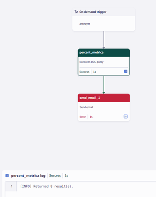

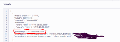

hi there, im facing the same issue when developing a workflow that must send an email when the JVM% threshold is reached. Im using  a DQL query that brings records ( jvm metric from diferent processes) and what we must do is: if the metric of any of those processes is above 80%, send the email alert (on a next step we want to alert also through ansible) so far the the DQL gives me this data:
but when doing the condition on the next step it fails
im using the records variable from the last step that brings the 8 records but on the email step it shows othe info and doesnt work.
