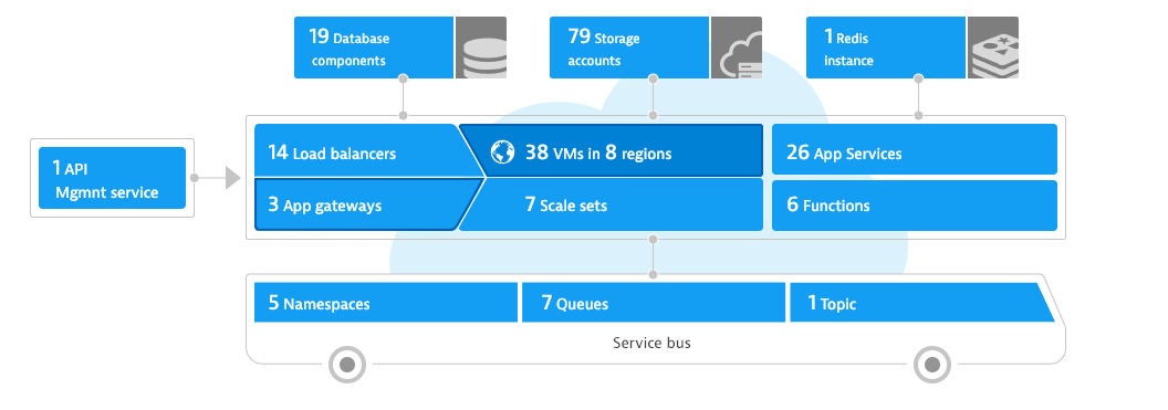

See what entities you can monitor:
maybe this will be helpful for you:
https://www.dynatrace.com/support/help/cloud-platforms/azure/ - here is some additional info. Unfortunately I'm not familiar with Azure because non of my clients use it. I think the best would be documentation check. If you have any option for testing such integration do so. It does not consume extra licenses.
