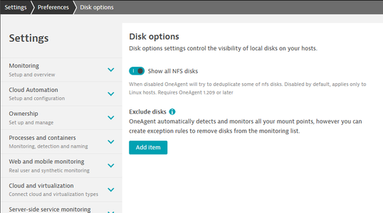

Mizső
Hi @lockandfire,
To be honest I rarely meet with app only integration (and I do not know the detailed limitation of it How it works - Dynatrace Docs) but could you please  check this settings? Maybe it can help.
Best regards,
Mizső
Hi, Mizső. Thank you for the information. We can confirm that this option is checked.
We thought that in the container environment the OneAgent should work almost the same as in the real hosts. We might be wrong.
