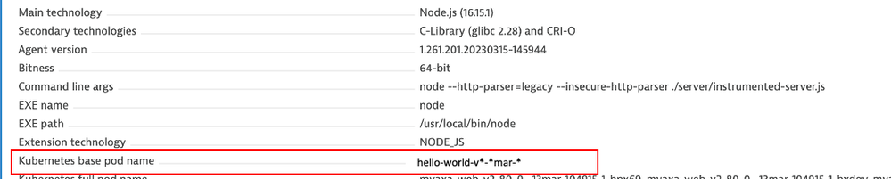

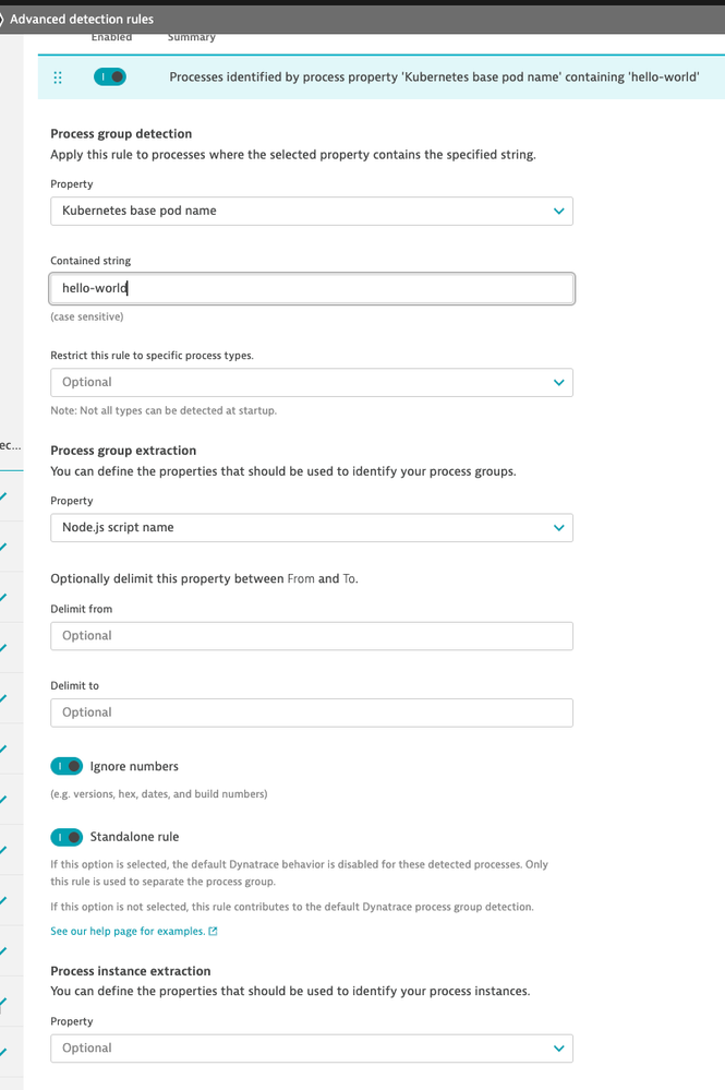

Hello,
I want to merge all the different deployment config pods log to one Process group. The deployment configs naming convention is like <application_name>-<version>-<date><month>. For example hello-world-v1-1-0-20mar, hello-world-v1-2-0-21apr, hello-world-v1-3-0-22may.
To achieve that I created an advanced detection rule but still it's not working. I have tried chnaging the value such as hello-world-v, hello-world-v*, hello-world-. But none of them worked. One agent automatically define the Kubernetes base Pod name like: <application_name>-v*-*<month>. I know I can represent the month value as digit by why DT not replacing the month value with an asterisk as well?

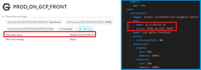

For several Customers to avoid problems with automatic rules we control Process Groups with Environment variable DT_CLUSTER_ID.
With this approach we don't need additional rules, and for Application teams it is also very simple to define and manage.

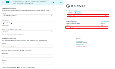

Maybe to try with Process Group extraction rules, to try extract and have this process group name "hello-world" instead hello-world-v*-*-*-*mar. (test-deployment-k*c-t*n)

Hello,
Thank you for your reply. Unfortunately, it didn't work. As the base pod name gets changed every time it creates a new process group with the same name but a different kubernetes base pod name.

Unfortunately there's no way to modify the extracted content. You can just make it ignore the month by putting a placeholder as first char and before the month itself. For example let
become
#hello-world-v1-3-0-22#may
And then in extraction rule delimit name between # and # so it will become
hello-world-v*-*-*-* for all of them
