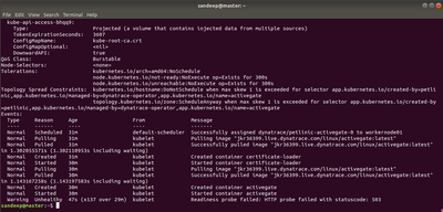

sudo kubectl describe pod petlinic-activegate-0 -n dynatrace
Namespace:        dynatrace
Priority:         0
Service Account:  dynatrace-kubernetes-monitoring
Node:             workernode01/192.168.0.207
Start Time:       Mon, 19 Jun 2023 13:29:24 +0530
Labels:           app.kubernetes.io/component=activegate
                  app.kubernetes.io/created-by=petlinic
                  app.kubernetes.io/managed-by=dynatrace-operator
                  app.kubernetes.io/name=activegate
                  app.kubernetes.io/version=1.267.118.20230602-131900
                  controller-revision-hash=petlinic-activegate-5cb68bb95
                  statefulset.kubernetes.io/pod-name=petlinic-activegate-0
Annotations:      internal.operator.dynatrace.com/activegate-configuration-hash: 3794628405
Status:           Running
IP:               10.244.1.119
IPs:
  IP:           10.244.1.119
Controlled By:  StatefulSet/petlinic-activegate
Init Containers:
  certificate-loader:
    Container ID:    containerd://8a345ce4510879ede3dbe4f63e42bfb3383b785731f954aa7af4b1688908042c
    Image:           xxxxx.live.dynatrace.com/linux/activegate:latest
    Image ID:        xxxxxx.live.dynatrace.com/linux/activegate@sha256:a3ceeb36fa5c40c8ab3e73c3de9e16d2035f70dbfd79f5aa94eef3677bec009d
    Port:            <none>
    Host Port:       <none>
    SeccompProfile:  RuntimeDefault
    Command:
      /bin/bash
    Args:
      -c
      /opt/dynatrace/gateway/k8scrt2jks.sh
    State:          Terminated
      Reason:       Completed
      Exit Code:    0
      Started:      Mon, 19 Jun 2023 13:29:28 +0530
      Finished:     Mon, 19 Jun 2023 13:29:31 +0530
    Ready:          True
    Restart Count:  0
    Limits:
      cpu:     1
      memory:  1536Mi
    Requests:
      cpu:        500m
      memory:     512Mi
    Environment:  <none>
    Mounts:
      /var/lib/dynatrace/gateway/ssl from truststore-volume (rw)
      /var/run/secrets/kubernetes.io/serviceaccount from kube-api-access-bhqq9 (ro)
Containers:
  activegate:
    Container ID:    containerd://eb783166fdfb57ed0ec2a31416d1d784a9efc3fd2edd277689d3bb21df08a092
    Image:           xxxxxx.live.dynatrace.com/linux/activegate:latest
    Port:            9999/TCP
    Host Port:       0/TCP
    State:           Running
      Started:       Mon, 19 Jun 2023 13:29:34 +0530
    Ready:           False
    Restart Count:   0
    Limits:
      cpu:     1
      memory:  1536Mi
    Requests:
      cpu:      500m
      memory:   512Mi
    Readiness:  http-get https://:https/rest/health delay=90s timeout=1s period=15s #success=1 #failure=3
    Environment:
      DT_CAPABILITIES:            MSGrouter,kubernetes_monitoring,restInterface
      DT_ID_SEED_NAMESPACE:       dynatrace
      DT_ID_SEED_K8S_CLUSTER_ID:  5e381001-fe93-4898-b43c-dcdfd8443512
      DT_DEPLOYMENT_METADATA:     <set to the key 'activegate' of config map 'petlinic-deployment-metadata'>                      Optional: false
      DT_TENANT:                  <set to the key 'tenant-uuid' of config map 'petlinic-activegate-connection-info'>              Optional: false
      DT_SERVER:                  <set to the key 'communication-endpoints' of config map 'petlinic-activegate-connection-info'>  Optional: false
      DT_DNS_ENTRY_POINT:         https://$(PETLINIC_ACTIVEGATE_SERVICE_HOST):$(PETLINIC_ACTIVEGATE_SERVICE_PORT)/communication
    Mounts:
      /opt/dynatrace/gateway/jre/lib/security/cacerts from truststore-volume (ro,path="k8s-local.jks")
      /var/lib/dynatrace/secrets/tokens/auth-token from ag-authtoken-secret (ro,path="auth-token")
      /var/lib/dynatrace/secrets/tokens/tenant-token from connection-info-secret (ro,path="tenant-token")
Conditions:
  Type              Status
  Initialized       True
  Ready             False
  ContainersReady   False
  PodScheduled      True
Volumes:
  ag-authtoken-secret:
    Type:        Secret (a volume populated by a Secret)
    SecretName:  petlinic-activegate-authtoken-secret
    Optional:    false
  connection-info-secret:
    SecretName:  petlinic-activegate-tenant-secret
    Optional:    false
  truststore-volume:
    Type:       EmptyDir (a temporary directory that shares a pod's lifetime)
    Medium:
    SizeLimit:  <unset>
  kube-api-access-bhqq9:
    Type:                     Projected (a volume that contains injected data from multiple sources)
    TokenExpirationSeconds:   3607
    ConfigMapName:            kube-root-ca.crt
    ConfigMapOptional:        <nil>
    DownwardAPI:              true
QoS Class:                    Burstable
Node-Selectors:               <none>
Tolerations:                  kubernetes.io/arch=amd64:NoSchedule
                              node.kubernetes.io/not-ready:NoExecute op=Exists for 300s
                              node.kubernetes.io/unreachable:NoExecute op=Exists for 300s
Topology Spread Constraints:  kubernetes.io/hostname:DoNotSchedule when max skew 1 is exceeded for selector app.kubernetes.io/created-by=petlinic,app.kubernetes.io/managed-by=dynatrace-operator,app.kubernetes.io/name=activegate
                              topology.kubernetes.io/zone:ScheduleAnyway when max skew 1 is exceeded for selector app.kubernetes.io/created-by=petlinic,app.kubernetes.io/managed-by=dynatrace-operator,app.kubernetes.io/name=activegate
Events:
  Type     Reason     Age                  From     Message
  Warning  Unhealthy  28s (x426 over 88m)  kubelet  Readiness probe failed: HTTP probe failed with statuscode: 503

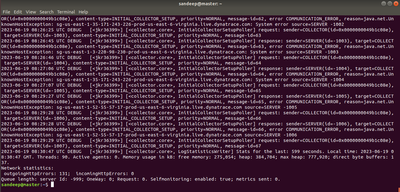

Hi @radek_jasinski ,
yes, that is all the information when i execute describe command. the below is the log for that activegate pod. Can you please check this.
Thanks

sandeep@master:~$ sudo kubectl logs  petlinic-activegate-0 -n dynatrace
Defaulted container "activegate" out of: activegate, certificate-loader (init)
Copy configuration templates to /var/lib/dynatrace/gateway/config
Assigned id = 0x49b1c08e
Setting environment AG token
Applying default config
Enabling selected features: MSGrouter,kubernetes_monitoring,restInterface
Setting dns entry point to https://{environmentid}.live.dynatrace.com/communication;-1], [https://{environmentid}.live.dynatrace.com/communication;-1], [https://{environmentid}.live.dynatrace.com/communication;-1], [https://{environmentid}.live.dynatrace.com/communication;-1], [https://{environmentid}.live.dynatrace.com/communication;-1], [https://{environmentid}.live.dynatrace.com/communication;-1], [https://{environmentid}.live.dynatrace.com/communication;-1], [https://{environmentid}.live.dynatrace.com:443/communication;-1]],
System: startupTimestamp = 1687354006981, osInfo = Platform: Linux, Version: 5.4.0-150-generic, Architecture: amd64, Processors: 1, jvmInfo = VM: OpenJDK 64-Bit Server VM, Version: 11.0.18, Vendor: Eclipse Adoptium, Memory [maxMemory=759M, initHeap=384M, maxHeap=759M, usedMeta=14M, committedMeta=15M, totalPhysicalMemory=1536M, freePhysicalMemory=1407M], buildVersion = 1.267.43.20230512-112635
EntityType: COLLECTOR, isRunningInContainer = true
2023-06-21 13:27:32 UTC INFO    [<jkr36399>] [<com.compuware.apm.debug.beaconforwarder>, BeaconForwarderService] Beacon Forwarder disabled. Skipping initialization of UEM Configuration Poller and synthetic results reporter.
2023-06-21 13:27:32 UTC INFO    [<jkr36399>] [HttpClientServiceImpl] No proxy server configured.
2023-06-21 13:27:32 UTC INFO    [<jkr36399>] [<collector>, CollectorLifeCycle] Collector Operation State = 'STARTUP_CONNECTING'
2023-06-21 13:27:32 UTC INFO    [<jkr36399>] [<collector.services>, ServicesManager] State changed from 'STARTUP_INIT' to 'STARTUP_CONNECTING'
2023-06-21 13:27:32 UTC INFO    [<jkr36399>] [<collector.services>, ServicesManager] Initializing services..
2023-06-21 13:27:32 UTC INFO    [<jkr36399>] [GenericFileCacheModuleImpl] Generic filecache service initialized.
2023-06-21 13:27:32 UTC INFO    [<jkr36399>] [<collector.comm>, LocalSupportArchiveService] LocalSupportArchive service initialized.
2023-06-21 13:27:32 UTC INFO    [<jkr36399>] [GenericIngestModule] Generic ingest service initialized.
2023-06-21 13:27:32 UTC INFO    [<jkr36399>] [<collector.services>, ServicesManager] Registering message handlers...
2023-06-21 13:27:32 UTC INFO    [<jkr36399>] [<collector.modules>, ModulesManager] State changed from 'STARTUP_INIT' to 'STARTUP_CONNECTING'
2023-06-21 13:27:32 UTC INFO    [<jkr36399>] [<collector.modules>, ModulesManager] Registering message handlers...
2023-06-21 13:27:32 UTC INFO    [<jkr36399>] [<collector.modules>, ModulesManager] Initializing modules..
2023-06-21 13:27:32 UTC INFO    [<jkr36399>] [<collector.modules>, ModulesManager] kubernetes_monitoring module is ready.
2023-06-21 13:27:32 UTC INFO    [<jkr36399>] [OdinModule] Odin module initialized.
2023-06-21 13:27:32 UTC INFO    [<jkr36399>] [<collector.modules>, ModulesManager] odin_collector module is ready.
2023-06-21 13:27:32 UTC INFO    [<jkr36399>] [RunningStateController] state: ACTIVE_GATE=false,BEACON_FORWARDER_WAIT=false,BEACON_FORWARDER_READY=false,MODULES=true,operationState='STARTUP_CONNECTING'
2023-06-21 13:27:32 UTC INFO    [<jkr36399>] [<collector.core>, CollectorSelfMonitoringPoller] stop Collector Self Monitoring Poller
2023-06-21 13:27:32 UTC INFO    [<jkr36399>] [<collector.core>, SelfMonitoringPeriodicSender] stop Collector Self Monitoring periodic sender
2023-06-21 13:27:32 UTC INFO    [<jkr36399>] [<collector.core>, CollectorRuntimeImpl] Collector started successfully.
2023-06-21 13:27:32 UTC DEBUG   [<jkr36399>] [<collector.core>, LogStatisticsWriter] Stats for the last: 0 seconds. Local time: 2023-06-21 13:27:32 GMT. Threads: 82. Active agents: 0. Memory usage in kB: free memory: 319,348; heap: 384,704; max heap: 777,920; direct byte buffers: 8.
Network statistics:
 outgoingHttpErrors: 0;  incomingHttpErrors: 0
Queue length: server Id: -999; OneWay: 0; Request: 0. Selfmonitoring: enabled: true; metrics sent: 0.
2023-06-21 13:27:33 UTC INFO    [<jkr36399>] [HttpClientServiceImpl] No proxy server configured.
2023-06-21 13:27:34 UTC DEBUG   [<jkr36399>] [<collector.core>, InitialCollectorSetupPoller] request: sender=COLLECTOR(id=0x0000000049b1c08e), target=ANY_SERVER(id=0x0000000000000000), content-type=INITIAL_COLLECTOR_SETUP, priority=NORMAL, message-id=2
2023-06-21 13:27:34 UTC DEBUG   [<jkr36399>] [<collector.core>, InitialCollectorSetupPoller] response: sender=ANY_SERVER(id=0x0000000000000000), target=COLLECTOR(id=0x0000000049b1c08e), content-type=INITIAL_COLLECTOR_SETUP, priority=NORMAL, message-id=2, error COMMUNICATION_ERROR, reason=java.net.UnknownHostException: sg-us-east-1-52-55-57-17-prod-us-east-6-virginia.live.dynatrace.com source=ANY_SERVER 0x0000000000000000
2023-06-21 13:27:34 UTC WARNING [<jkr36399>] [<collector.core>, InitialCollectorSetupPoller] Initial collector setup received with error:COMMUNICATION_ERROR, reason=java.net.UnknownHostException: sg-us-east-1-52-55-57-17-prod-us-east-6-virginia.live.dynatrace.com source=ANY_SERVER 0x0000000000000000 [Suppressing further messages for 1 hour]
2023-06-21 13:27:35 UTC DEBUG   [<jkr36399>] [<collector.core>, InitialCollectorSetupPoller] request: sender=COLLECTOR(id=0x0000000049b1c08e), target=ANY_SERVER(id=0x0000000000000000), content-type=INITIAL_COLLECTOR_SETUP, priority=NORMAL, message-id=3
2023-06-21 13:27:35 UTC DEBUG   [<jkr36399>] [<collector.core>, InitialCollectorSetupPoller] response: sender=ANY_SERVER(id=0x0000000000000000), target=COLLECTOR(id=0x0000000049b1c08e), content-type=INITIAL_COLLECTOR_SETUP, priority=NORMAL, message-id=3, error COMMUNICATION_ERROR, reason=java.net.UnknownHostException: sg-us-east-1-34-237-88-136-prod-us-east-6-virginia.live.dynatrace.com source=ANY_SERVER 0x0000000000000000
2023-06-21 13:27:36 UTC DEBUG   [<jkr36399>] [<collector.core>, InitialCollectorSetupPoller] request: sender=COLLECTOR(id=0x0000000049b1c08e), target=ANY_SERVER(id=0x0000000000000000), content-type=INITIAL_COLLECTOR_SETUP, priority=NORMAL, message-id=4
2023-06-21 13:27:36 UTC WARNING [<jkr36399>] [<collector.core>, CommunicationLayer] Collector starts failover mode
2023-06-21 13:27:36 UTC INFO    [<jkr36399>] [<collector>, CollectorLifeCycle] Collector Operation State = 'FAILOVER'
2023-06-21 13:27:36 UTC INFO    [<jkr36399>] [<collector.services>, ServicesManager] State changed from 'STARTUP_CONNECTING' to 'FAILOVER'
2023-06-21 13:27:36 UTC INFO    [<jkr36399>] [<collector.modules>, ModulesManager] State changed from 'STARTUP_CONNECTING' to 'FAILOVER'
2023-06-21 13:27:36 UTC INFO    [<jkr36399>] [<collector.core>, Identification] Stop identification messages thread
2023-06-21 13:27:36 UTC INFO    [<jkr36399>] [<collector.comm>, ClusterRuntimeInfoPoller] stop cluster runtime info poller
2023-06-21 13:27:36 UTC INFO    [<jkr36399>] [<collector.comm>, ClusterTimePoller] stop cluster time poller
2023-06-21 13:27:36 UTC INFO    [<jkr36399>] [<collector.core>, ConfigurationPoller] stop configuration poller
2023-06-21 13:27:36 UTC INFO    [<jkr36399>] [<collector.core>, InitialCollectorSetupPoller] start initial collector setup poller in failover mode
2023-06-21 13:27:36 UTC DEBUG   [<jkr36399>] [<collector.core>, InitialCollectorSetupPoller] request: sender=COLLECTOR(id=0x0000000049b1c08e), target=SERVER(id=-999), content-type=INITIAL_COLLECTOR_SETUP, priority=NORMAL, message-id=5
2023-06-21 13:27:36 UTC WARNING [<jkr36399>] [<collector.core>, CommunicationLayer] Collector started failover mode
2023-06-21 13:27:36 UTC DEBUG   [<jkr36399>] [<collector.core>, InitialCollectorSetupPoller] response: sender=SERVER(id=-999), target=COLLECTOR(id=0x0000000049b1c08e), content-type=INITIAL_COLLECTOR_SETUP, priority=NORMAL, message-id=5, error COMMUNICATION_ERROR, reason=java.net.UnknownHostException: sg-us-east-1-52-4-253-12-prod-us-east-6-virginia.live.dynatrace.com source=SERVER -999
2023-06-21 13:27:36 UTC DEBUG   [<jkr36399>] [<collector.core>, InitialCollectorSetupPoller] response: sender=ANY_SERVER(id=0x0000000000000000), target=COLLECTOR(id=0x0000000049b1c08e), content-type=INITIAL_COLLECTOR_SETUP, priority=NORMAL, message-id=4, error COMMUNICATION_ERROR, reason=java.net.UnknownHostException: sg-us-east-1-34-236-11-154-prod-us-east-6-virginia.live.dynatrace.com source=ANY_SERVER 0x0000000000000000
2023-06-21 13:27:37 UTC DEBUG   [<jkr36399>] [<collector.core>, InitialCollectorSetupPoller] request: sender=COLLECTOR(id=0x0000000049b1c08e), target=SERVER(id=-1000), content-type=INITIAL_COLLECTOR_SETUP, priority=NORMAL, message-id=6
2023-06-21 13:27:37 UTC DEBUG   [<jkr36399>] [<collector.core>, InitialCollectorSetupPoller] response: sender=SERVER(id=-1000), target=COLLECTOR(id=0x0000000049b1c08e), content-type=INITIAL_COLLECTOR_SETUP, priority=NORMAL, message-id=6, error COMMUNICATION_ERROR, reason=java.net.UnknownHostException: sg-us-east-1-35-171-243-226-prod-us-east-6-virginia.live.dynatrace.com source=SERVER -1000
2023-06-21 13:27:38 UTC DEBUG   [<jkr36399>] [<collector.core>, InitialCollectorSetupPoller] request: sender=COLLECTOR(id=0x0000000049b1c08e), target=SERVER(id=-1001), content-type=INITIAL_COLLECTOR_SETUP, priority=NORMAL, message-id=7
2023-06-21 13:27:38 UTC DEBUG   [<jkr36399>] [<collector.core>, InitialCollectorSetupPoller] response: sender=SERVER(id=-1001), target=COLLECTOR(id=0x0000000049b1c08e), content-type=INITIAL_COLLECTOR_SETUP, priority=NORMAL, message-id=7, error COMMUNICATION_ERROR, reason=java.net.UnknownHostException: sg-us-east-1-52-55-57-17-prod-us-east-6-virginia.live.dynatrace.com source=SERVER -1001
2023-06-21 13:27:39 UTC DEBUG   [<jkr36399>] [<collector.core>, InitialCollectorSetupPoller] request: sender=COLLECTOR(id=0x0000000049b1c08e), target=SERVER(id=-1002), content-type=INITIAL_COLLECTOR_SETUP, priority=NORMAL, message-id=8
2023-06-21 13:27:39 UTC DEBUG   [<jkr36399>] [<collector.core>, InitialCollectorSetupPoller] response: sender=SERVER(id=-1002), target=COLLECTOR(id=0x0000000049b1c08e), content-type=INITIAL_COLLECTOR_SETUP, priority=NORMAL, message-id=8, error COMMUNICATION_ERROR, reason=java.net.UnknownHostException: sg-us-east-1-34-237-88-136-prod-us-east-6-virginia.live.dynatrace.com source=SERVER -1002
2023-06-21 13:27:40 UTC DEBUG   [<jkr36399>] [<collector.core>, InitialCollectorSetupPoller] request: sender=COLLECTOR(id=0x0000000049b1c08e), target=SERVER(id=-1003), content-type=INITIAL_COLLECTOR_SETUP, priority=NORMAL, message-id=9
2023-06-21 13:27:40 UTC DEBUG   [<jkr36399>] [<collector.core>, InitialCollectorSetupPoller] response: sender=SERVER(id=-1003), target=COLLECTOR(id=0x0000000049b1c08e), content-type=INITIAL_COLLECTOR_SETUP, priority=NORMAL, message-id=9, error COMMUNICATION_ERROR, reason=java.net.UnknownHostException: sg-us-east-1-34-237-88-136-prod-us-east-6-virginia.live.dynatrace.com source=SERVER -1003
2023-06-21 13:27:41 UTC DEBUG   [<jkr36399>] [<collector.core>, InitialCollectorSetupPoller] request: sender=COLLECTOR(id=0x0000000049b1c08e), target=SERVER(id=-1004), content-type=INITIAL_COLLECTOR_SETUP, priority=NORMAL, message-id=10
2023-06-21 13:27:41 UTC DEBUG   [<jkr36399>] [<collector.core>, InitialCollectorSetupPoller] response: sender=SERVER(id=-1004), target=COLLECTOR(id=0x0000000049b1c08e), content-type=INITIAL_COLLECTOR_SETUP, priority=NORMAL, message-id=10, error COMMUNICATION_ERROR, reason=java.net.UnknownHostException: jkr36399.live.dynatrace.com source=SERVER -1004
2023-06-21 13:27:42 UTC DEBUG   [<jkr36399>] [<collector.core>, InitialCollectorSetupPoller] request: sender=COLLECTOR(id=0x0000000049b1c08e), target=SERVER(id=-1005), content-type=INITIAL_COLLECTOR_SETUP, priority=NORMAL, message-id=11
2023-06-21 13:28:02 UTC DEBUG   [<jkr36399>] [<collector.core>, InitialCollectorSetupPoller] response: sender=SERVER(id=-1005), target=COLLECTOR(id=0x0000000049b1c08e), content-type=INITIAL_COLLECTOR_SETUP, priority=NORMAL, message-id=11, error COMMUNICATION_ERROR, reason=java.net.UnknownHostException: sg-us-east-1-52-55-57-17-prod-us-east-6-virginia.live.dynatrace.com: System error source=SERVER -1005
2023-06-21 13:28:03 UTC DEBUG   [<jkr36399>] [<collector.core>, InitialCollectorSetupPoller] request: sender=COLLECTOR(id=0x0000000049b1c08e), target=SERVER(id=-1006), content-type=INITIAL_COLLECTOR_SETUP, priority=NORMAL, message-id=12
2023-06-21 13:28:03 UTC DEBUG   [<jkr36399>] [<collector.core>, InitialCollectorSetupPoller] response: sender=SERVER(id=-1006), target=COLLECTOR(id=0x0000000049b1c08e), content-type=INITIAL_COLLECTOR_SETUP, priority=NORMAL, message-id=12, error COMMUNICATION_ERROR, reason=java.net.UnknownHostException: sg-us-east-1-52-55-57-17-prod-us-east-6-virginia.live.dynatrace.com source=SERVER -1006
2023-06-21 13:28:04 UTC DEBUG   [<jkr36399>] [<collector.core>, InitialCollectorSetupPoller] request: sender=COLLECTOR(id=0x0000000049b1c08e), target=SERVER(id=-1007), content-type=INITIAL_COLLECTOR_SETUP, priority=NORMAL, message-id=13
2023-06-21 13:28:24 UTC DEBUG   [<jkr36399>] [<collector.core>, InitialCollectorSetupPoller] response: sender=SERVER(id=-1007), target=COLLECTOR(id=0x0000000049b1c08e), content-type=INITIAL_COLLECTOR_SETUP, priority=NORMAL, message-id=13, error COMMUNICATION_ERROR, reason=java.net.UnknownHostException: sg-us-east-1-3-220-98-230-prod-us-east-6-virginia.live.dynatrace.com: System error source=SERVER -1007
2023-06-21 13:28:25 UTC DEBUG   [<jkr36399>] [<collector.core>, InitialCollectorSetupPoller] request: sender=COLLECTOR(id=0x0000000049b1c08e), target=SERVER(id=-999), content-type=INITIAL_COLLECTOR_SETUP, priority=NORMAL, message-id=14
2023-06-21 13:28:45 UTC DEBUG   [<jkr36399>] [<collector.core>, InitialCollectorSetupPoller] response: sender=SERVER(id=-999), target=COLLECTOR(id=0x0000000049b1c08e), content-type=INITIAL_COLLECTOR_SETUP, priority=NORMAL, message-id=14, error COMMUNICATION_ERROR, reason=java.net.UnknownHostException: sg-us-east-1-52-4-253-12-prod-us-east-6-virginia.live.dynatrace.com: System error source=SERVER -999
2023-06-21 13:28:46 UTC DEBUG   [<jkr36399>] [<collector.core>, InitialCollectorSetupPoller] request: sender=COLLECTOR(id=0x0000000049b1c08e), target=SERVER(id=-1000), content-type=INITIAL_COLLECTOR_SETUP, priority=NORMAL, message-id=15
2023-06-21 13:29:06 UTC DEBUG   [<jkr36399>] [<collector.core>, InitialCollectorSetupPoller] response: sender=SERVER(id=-1000), target=COLLECTOR(id=0x0000000049b1c08e), content-type=INITIAL_COLLECTOR_SETUP, priority=NORMAL, message-id=15, error COMMUNICATION_ERROR, reason=java.net.UnknownHostException: sg-us-east-1-3-220-98-230-prod-us-east-6-virginia.live.dynatrace.com: System error source=SERVER -1000
2023-06-21 13:29:07 UTC DEBUG   [<jkr36399>] [<collector.core>, InitialCollectorSetupPoller] request: sender=COLLECTOR(id=0x0000000049b1c08e), target=SERVER(id=-1001), content-type=INITIAL_COLLECTOR_SETUP, priority=NORMAL, message-id=16
2023-06-21 13:29:07 UTC DEBUG   [<jkr36399>] [<collector.core>, InitialCollectorSetupPoller] response: sender=SERVER(id=-1001), target=COLLECTOR(id=0x0000000049b1c08e), content-type=INITIAL_COLLECTOR_SETUP, priority=NORMAL, message-id=16, error COMMUNICATION_ERROR, reason=java.net.UnknownHostException: sg-us-east-1-3-220-98-230-prod-us-east-6-virginia.live.dynatrace.com source=SERVER -1001
2023-06-21 13:29:08 UTC DEBUG   [<jkr36399>] [<collector.core>, InitialCollectorSetupPoller] request: sender=COLLECTOR(id=0x0000000049b1c08e), target=SERVER(id=-1002), content-type=INITIAL_COLLECTOR_SETUP, priority=NORMAL, message-id=17
2023-06-21 13:29:28 UTC DEBUG   [<jkr36399>] [<collector.core>, InitialCollectorSetupPoller] response: sender=SERVER(id=-1002), target=COLLECTOR(id=0x0000000049b1c08e), content-type=INITIAL_COLLECTOR_SETUP, priority=NORMAL, message-id=17, error COMMUNICATION_ERROR, reason=java.net.UnknownHostException: sg-us-east-1-34-236-11-154-prod-us-east-6-virginia.live.dynatrace.com: System error source=SERVER -1002
2023-06-21 13:29:29 UTC DEBUG   [<jkr36399>] [<collector.core>, InitialCollectorSetupPoller] request: sender=COLLECTOR(id=0x0000000049b1c08e), target=SERVER(id=-1003), content-type=INITIAL_COLLECTOR_SETUP, priority=NORMAL, message-id=18
2023-06-21 13:29:49 UTC DEBUG   [<jkr36399>] [<collector.core>, InitialCollectorSetupPoller] response: sender=SERVER(id=-1003), target=COLLECTOR(id=0x0000000049b1c08e), content-type=INITIAL_COLLECTOR_SETUP, priority=NORMAL, message-id=18, error COMMUNICATION_ERROR, reason=java.net.UnknownHostException: sg-us-east-1-35-171-243-226-prod-us-east-6-virginia.live.dynatrace.com: System error source=SERVER -1003
2023-06-21 13:29:50 UTC DEBUG   [<jkr36399>] [<collector.core>, InitialCollectorSetupPoller] request: sender=COLLECTOR(id=0x0000000049b1c08e), target=SERVER(id=-1004), content-type=INITIAL_COLLECTOR_SETUP, priority=NORMAL, message-id=19
2023-06-21 13:30:10 UTC DEBUG   [<jkr36399>] [<collector.core>, InitialCollectorSetupPoller] response: sender=SERVER(id=-1004), target=COLLECTOR(id=0x0000000049b1c08e), content-type=INITIAL_COLLECTOR_SETUP, priority=NORMAL, message-id=19, error COMMUNICATION_ERROR, reason=java.net.UnknownHostException: sg-us-east-1-52-4-253-12-prod-us-east-6-virginia.live.dynatrace.com: System error source=SERVER -1004
2023-06-21 13:30:11 UTC DEBUG   [<jkr36399>] [<collector.core>, InitialCollectorSetupPoller] request: sender=COLLECTOR(id=0x0000000049b1c08e), target=SERVER(id=-1005), content-type=INITIAL_COLLECTOR_SETUP, priority=NORMAL, message-id=20
2023-06-21 13:30:11 UTC DEBUG   [<jkr36399>] [<collector.core>, InitialCollectorSetupPoller] response: sender=SERVER(id=-1005), target=COLLECTOR(id=0x0000000049b1c08e), content-type=INITIAL_COLLECTOR_SETUP, priority=NORMAL, message-id=20, error COMMUNICATION_ERROR, reason=java.net.UnknownHostException: sg-us-east-1-3-220-98-230-prod-us-east-6-virginia.live.dynatrace.com source=SERVER -1005
2023-06-21 13:30:12 UTC DEBUG   [<jkr36399>] [<collector.core>, InitialCollectorSetupPoller] request: sender=COLLECTOR(id=0x0000000049b1c08e), target=SERVER(id=-1006), content-type=INITIAL_COLLECTOR_SETUP, priority=NORMAL, message-id=21
2023-06-21 13:30:32 UTC DEBUG   [<jkr36399>] [<collector.core>, InitialCollectorSetupPoller] response: sender=SERVER(id=-1006), target=COLLECTOR(id=0x0000000049b1c08e), content-type=INITIAL_COLLECTOR_SETUP, priority=NORMAL, message-id=21, error COMMUNICATION_ERROR, reason=java.net.UnknownHostException: sg-us-east-1-35-171-243-226-prod-us-east-6-virginia.live.dynatrace.com: System error source=SERVER -1006
2023-06-21 13:30:33 UTC DEBUG   [<jkr36399>] [<collector.core>, InitialCollectorSetupPoller] request: sender=COLLECTOR(id=0x0000000049b1c08e), target=SERVER(id=-1007), content-type=INITIAL_COLLECTOR_SETUP, priority=NORMAL, message-id=22
2023-06-21 13:30:53 UTC DEBUG   [<jkr36399>] [<collector.core>, InitialCollectorSetupPoller] response: sender=SERVER(id=-1007), target=COLLECTOR(id=0x0000000049b1c08e), content-type=INITIAL_COLLECTOR_SETUP, priority=NORMAL, message-id=22, error COMMUNICATION_ERROR, reason=java.net.UnknownHostException: sg-us-east-1-52-55-57-17-prod-us-east-6-virginia.live.dynatrace.com: System error source=SERVER -1007
2023-06-21 13:30:54 UTC DEBUG   [<jkr36399>] [<collector.core>, InitialCollectorSetupPoller] request: sender=COLLECTOR(id=0x0000000049b1c08e), target=SERVER(id=-999), content-type=INITIAL_COLLECTOR_SETUP, priority=NORMAL, message-id=23
2023-06-21 13:30:54 UTC DEBUG   [<jkr36399>] [<collector.core>, InitialCollectorSetupPoller] response: sender=SERVER(id=-999), target=COLLECTOR(id=0x0000000049b1c08e), content-type=INITIAL_COLLECTOR_SETUP, priority=NORMAL, message-id=23, error COMMUNICATION_ERROR, reason=java.net.UnknownHostException: sg-us-east-1-34-237-88-136-prod-us-east-6-virginia.live.dynatrace.com source=SERVER -999
2023-06-21 13:30:55 UTC DEBUG   [<jkr36399>] [<collector.core>, InitialCollectorSetupPoller] request: sender=COLLECTOR(id=0x0000000049b1c08e), target=SERVER(id=-1000), content-type=INITIAL_COLLECTOR_SETUP, priority=NORMAL, message-id=24
2023-06-21 13:31:15 UTC DEBUG   [<jkr36399>] [<collector.core>, InitialCollectorSetupPoller] response: sender=SERVER(id=-1000), target=COLLECTOR(id=0x0000000049b1c08e), content-type=INITIAL_COLLECTOR_SETUP, priority=NORMAL, message-id=24, error COMMUNICATION_ERROR, reason=java.net.UnknownHostException: sg-us-east-1-35-171-243-226-prod-us-east-6-virginia.live.dynatrace.com: System error source=SERVER -1000
2023-06-21 13:31:16 UTC DEBUG   [<jkr36399>] [<collector.core>, InitialCollectorSetupPoller] request: sender=COLLECTOR(id=0x0000000049b1c08e), target=SERVER(id=-1001), content-type=INITIAL_COLLECTOR_SETUP, priority=NORMAL, message-id=25
Do you have open network traffic? Please verify with Dynatrace recommendations.
You have an error in the logs indicating a lack of communication:
Have a nice day!
@radek_jasinski are you speaking about this recommendations
No, based on the log you have issues with the connection between ActiveGate and your Dynatrace cluster. You should to check this part of your system.
Maybe another good way is a use proxy for AG: https://www.dynatrace.com/support/help/setup-and-configuration/dynatrace-activegate/configuration/se...
Have a nice day!
