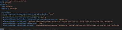

07 Jan 2024 11:03 PM
Hi All,
making an assumption on your configurations using proxy.
In operator 13.x, the operator introduces an Active Gate service on port 443 (not that it's documented), it used to be ignored to a certain extent until newer operators.
I've got similar errors this due to changes in the way that proxies are handled in the newer operators (14.x +), there was a 'fix' that Dynatrace put in place (I've requested documentation to be updated as part of our case, since it's not currently - Dynatrace Operator release notes version 0.14.2 - Dynatrace Docs).
To fix this, you need to apply the 'feature.dynatrace.com/no-proxy' and possibly the 'feature.dynatrace.com/oneagent-no-proxy' flags to allow for internal routing to occur to this service. Otherwise, what we found was that the pod connections would try to route through the proxy (which does not know about local services).
You can try updating your CRD similar to below
feature.dynatrace.com/no-proxy: "dynakube-activegate.dynatrace,dynakube-activegate.dynatrace.svc.cluster.local,.svc.cluster.local,.dynatrace"
feature.dynatrace.com/oneagent-ignore-proxy: "true"
feature.dynatrace.com/oneagent-no-proxy: "dynakube-activegate.dynatrace,dynakube-activegate.dynatrace.svc.cluster.local,.svc.cluster.local,.dynatrace"
hope this helps

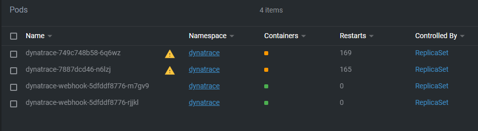

05 Jan 2024 05:28 PM
Hello
I was facing the same error as both of you when trying to deploy the operator v 13.x or 14.x
I can share with you my troubleshooting step and my findings, hope this can help you :
First I was trying to specify a proxy and increase ressources but no change.
Looking at the status I saw a lot of restart :
Then I run this command :
get pods -n dynatraceOperator stuck in a crashloop
k describe po [dynatrace-operator-pod] -n dynatraceWe can see a DNS probe failed to lookup
In our kube cluster this is because the service is not available on cluster.local
I finnally managed to deploy successfully the operator on the cluster.
We use the lastest version v15.0 released on Dec 13, 2023 which perfectly resolved our issue :
Hope this can help you.
