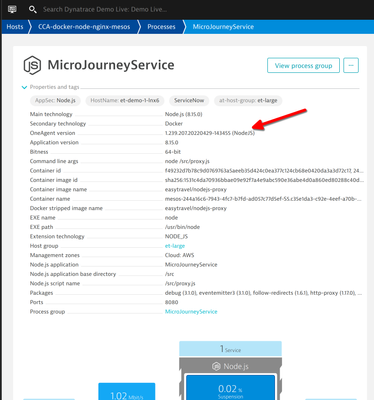

Nevertheless, first check if Dynatrace is injecting code modules into your NodeJS process. You can see that easily if you open the NodeJS process in Dynatrace UI and you will see the OneAgent version in the metadata:
If there is OneAgent version then there is definitely some issue with initializing - check the OneAgent log (Download the OneAgent diagnostic archive).
If there is no mention of OneAgent version, then Dynatrace is not injecting into your nodejs process. Maybe due to the deployment mode you are using or due to rules you have set up or the version you are running is not supported.
