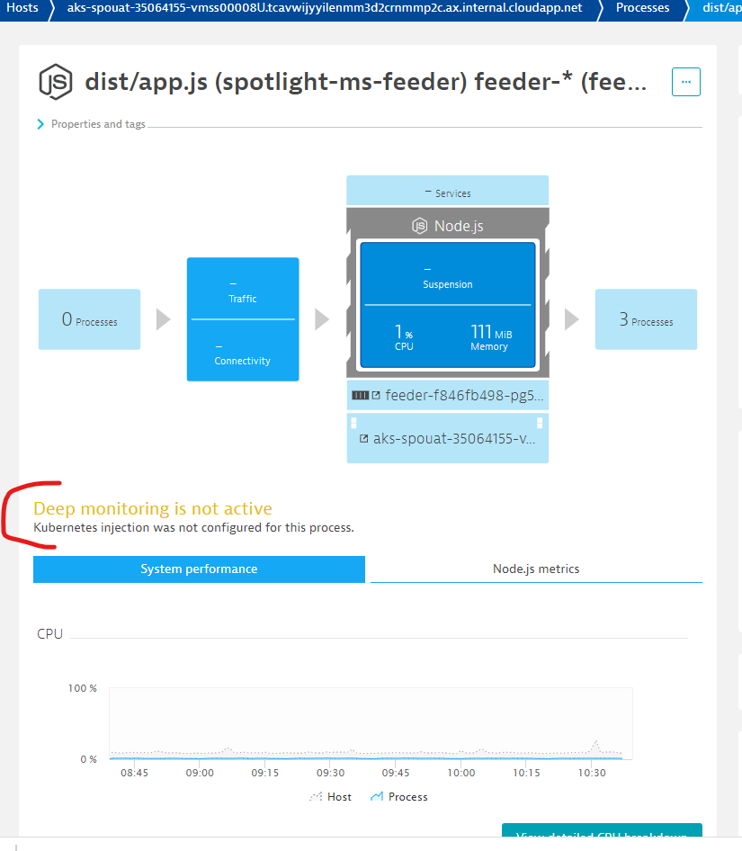

Hello everyone,
After I installed OneAgent with CloudNativeFullStack template in our AKS cluster, I'm not able to obtain any metrics. I have a message saying that the "Deep monitoring is not active" :
Do you have any idea or did you face this issue before?

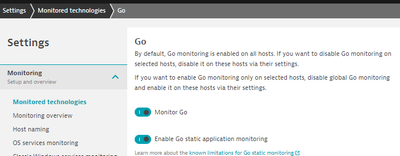

For GO apps, there are a variety of things that can prevent instrumentation.
Have you checked your 'GO' rules in these 2 places within settings.
Monitored Technologies -> GO
Also then check that the old GO static process monitoring rule is not enabled. There is a default duplicate inbuilt process monitoring rule that counters this primary enablement.
Process & containers -. built in monitoring rules. -> rule 47
These will prevent static GO apps from being instrumented.
