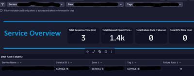

HI,
 I'm not looking for an error
I have created a dashboard and added filters for Service, Zone, and Tag. The filter for Service is working fine and the dashboard is being filtered accordingly when I select a service. However, when I try to filter by Zone or Tag, it doesn't work and doesn't display the required information on the dashboard.
I have checked the code and noticed that the following code is used for Service filtering:
"Service Name": result.dimensionMap["dt.entity.service.name"],
"Service ID": result.dimensionMap["dt.entity.service"]
But, I am not sure what code I should use for Zone and Tag filtering. I am not sure which "dt.xxx" I should use for Zone and Tag filtering or what I should configure in the code for filtering by Zone and Tag.

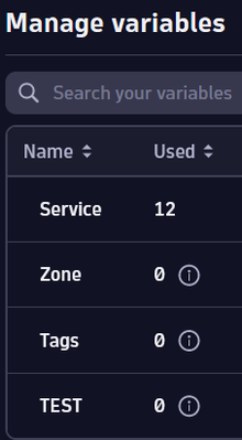

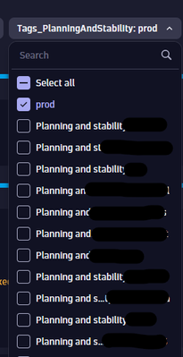

HI
I was able to create the filter that I needed. Now, I just need to link it to the code inside the table, which I attached above. I'm not sure how to insert this filter into the table's view.
fetch dt.entity.service
| expand tags
| filter contains(tags, "Planning and stability")
| fields managementZones, tags
gbaudart
DynaMight Champion
DynaMight Champion
If you “simply” have to take the filter value.
I think, You may use the $FILTER variable :
$Tags_PlanningAndStability
Dynatrace Partner - Professional Certified - DynaMight

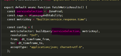

Could you assist me in inserting a value into this code? I am having trouble inserting it in a way that it will filter rather than tag. Below is the code that I have mentioned earlier
import { metricsClient } from '@dynatrace-sdk/client-classic-environment-v2';
export default async function fetchMetricResults() {
const serviceSelection = $Service;
const metricKey = "builtin:service.errors.total.rate";
const config = {
metricSelector: buildQuery(serviceSelection, metricKey),
resolution: "Inf",
from: $dt_timeframe_from,
to: $dt_timeframe_to,
acceptType: "application/json; charset=utf-8"
if (config.metricSelector.length > 3500) {
return "Please select fewer services";
const metricQuery = await metricsClient.query(config);
const processedResults: MetricResult[] = metricQuery.result[0].data.map(result => {
return {
"Service ID": result.dimensionMap["dt.entity.service"],
"Tag":  xxxxxxxxxxxxxxxxxxxxxxxxxxxxxxxxxxxxxxxxxxxxx,
"Failure Rate": +result.values
return processedResults;
function buildQuery(inputs: string[], metricKey: string): string {
const filters = inputs.map(
input => `in("dt.entity.service", entitySelector("type(service), entityName.equals(~"${input}~")"))`
const filterString = filters.join(",");
return `${metricKey}:filter(or(${filterString})):splitBy("dt.entity.service"):sort(value(auto, descending)):names`;
gbaudart
DynaMight Champion
DynaMight Champion
Try this :
return {
"Tag": $Tags_PlanningAndStability,
On the other hand, to improve the rereading of your code, you should indent it
There is progress now, and I can see the value. However, the filter doesn't really perform a filter like the service filter's function. It only shows what I mark inside the filter.
The classic dashboard where I make the change in the filter by filtering, so I see what service is inside that tag.
Thank you for your assistance and patience.

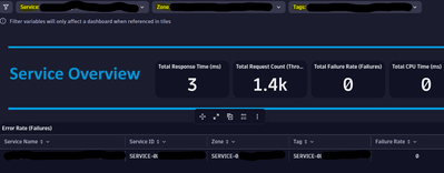

I was able to link a tag to the table, but you pointed out that the name of the service in the table is incorrect. I would like to display all the names under the same tag group. I need help figuring out how to do it.
HI, @gbaudart
I need to know how to search for a desired service using tags.
Maybe I need to change something here?
serviceSelection
This is the code-
https://paste.ofcode.org/3863CCfHHf3qzWB2REYYAGA
Could you please tell me where I can find an index or a way to debug it?
gbaudart
DynaMight Champion
DynaMight Champion
Hi @yuval1983
In the EntitySelector command, you can filter with the desired tags like this:
input => `in("dt.entity.service", entitySelector("type(service), entityName.equals(~"${input}~"), tag("$TAG_VARIABLE")"))`
