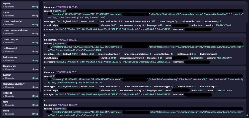

We are now starting to use GRAIL to create dashboards. However, we've encountered a problem: when the data is input into log monitoring, even the numbers in the JSON are recognized as strings.
Captured POST ingestion only string detectionCaptured POST ingestion only string detection

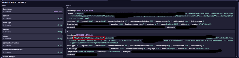

  2. Or parse it using DPL with the parse syntax `JSON:ingest`. And do not seems also to work correctly as we expected (only recognise duration).parsing using parse commad for jsonparsing using parse commad for json

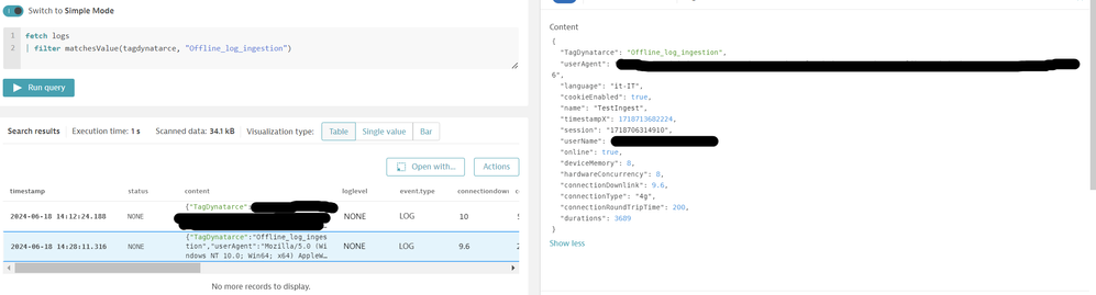

As you suggested to me I have create a custom rule to capture the logs in Settings > Log Monitoring > Processing.
This is the fetch log:
fetch logfetch log

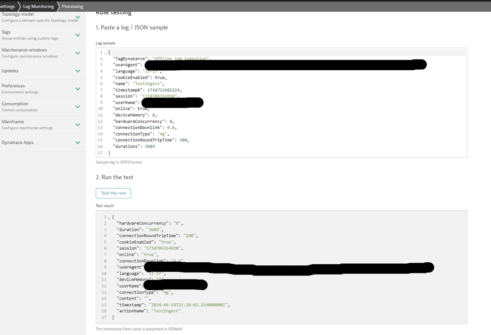

So I have created a new processig rule:
  1. I have use the same matcher in the log ingester
matchesValue(TagDynatarce, "Offline_log_ingestion")​
     2. And use this rule to pass my parameter with the correct type as I want:
USING(
    IN userAgent: STRING?,
    IN language: STRING?,
    IN cookieEnabled: BOOLEAN?,
    INOUT timestampX: TIMESTAMP,
    IN session: STRING,
    IN online: BOOLEAN?,
    IN deviceMemory: INTEGER?,
    IN hardwareConcurrency: INTEGER?,
    IN connectionDownlink: INTEGER?,
    IN connectionType: STRING,
    IN connectionRoundTripTime: INTEGER?,
    INOUT durations: INTEGER,
    INOUT name:STRING,
    INOUT userName:STRING,
    INOUT TagDynatarce:STRING
| FIELDS_RENAME(
    duration: durations,
    actionName: name,
    timestamp: timestampX
| FIELDS_REMOVE(durations, name, timestampX, TagDynatarce)​
3. After I test it and it is able to find and change the content. Test the ruleTest the rule

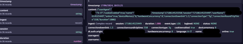

Now what I expect after I have defined this rule that in GRAL the json is correctly ingest and with the correct type of field, but it does not work.
GRAILGRAIL

Hello,
I don't see any error.
I see in the last photo that you have one new entry with the correct values. This rule only applies to new ingested logs, not to old logs.
