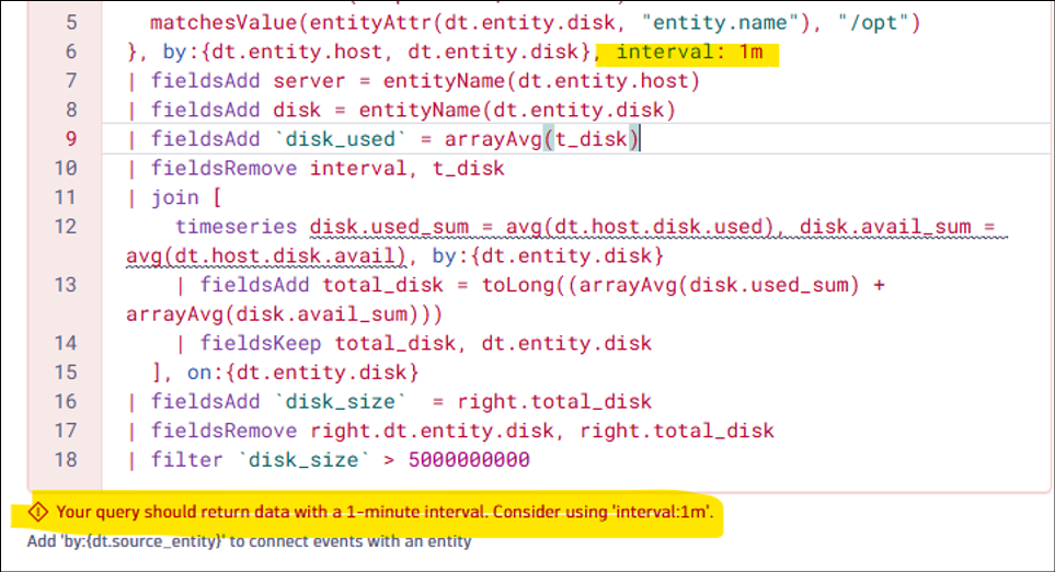

I would like to create an anomaly detector disk alert when disk is higher than some value. I am trying it using this DQL:

I am getting some interval error:
But I think issue is another thing. Do you have some suggestion? Have you received that error message before?

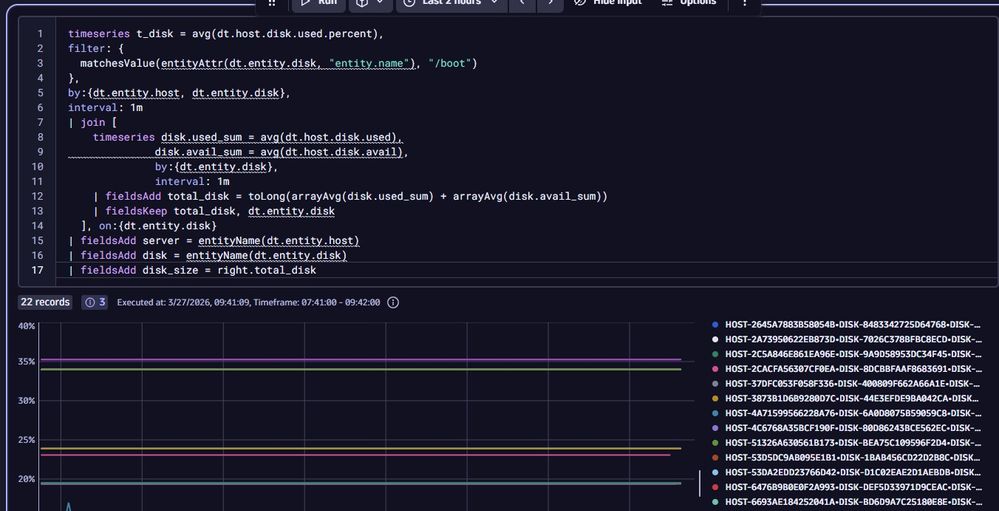

I thinkk the problem is here:
arrayAvg(t_disk) collapses the time series into a single value and fieldsRemove interval removes the interval information required by the detector
So for anomaly detection, your query should keep the original time series in the final output, and only use the join for filtering/enrichment. Try this:

Of course change filters 😉
You are right, before query should work if this line is removed:
| fieldsRemove interval, t_disk
 Thank you!
