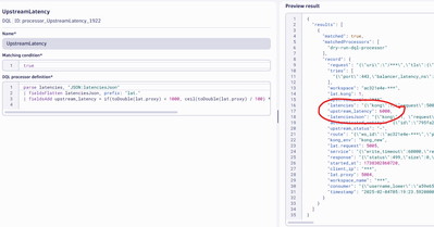

1️) Missing Metric Mystery:
I have a DQL statement that works perfectly when testing with "Run sample data." However, despite waiting patiently for days, the metric doesn’t show up anywhere. Here's the snippet:
parse latencies, "JSON:latenciesJson"
| fieldsFlatten latenciesJson, prefix: "lat."
| fieldsAdd upstream_latency = if(toDouble(lat.proxy) < 1000, ceil(toDouble(lat.proxy) / 100) * 100, else:ceil(toDouble(lat.proxy) / 1000) * 1000)

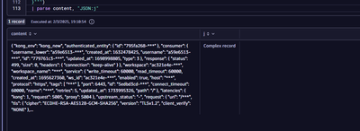

Hi Erwin.
I created a sample record using the JSON you have provided. By the looks, that is valid JSON meaning you are able to add a simple "|parse content, "JSON:j" at the end of the DQL query. This should end up looking something like this.
Hope this helps!
Hi Keegan,
Thanks for checking, and confirming the validity of the json. Indeed I'm parsing the json, and with the processing instruction
fieldsAdd upstream_status_code = if(upstream_status == "-", "499", else:substring(upstream_status, from:0, to:3))
The json is parsed implicitly, with the following instruction I explicitly parse the json:
And in OpenPipeline this looks good, however the metric is afterwards not available when querying the metric, like in notebook it should be available to select:
upstream_latency is also added to dimensions in the Metrics Extraction tab of the OpenPipeline, imho it should work but it doesn't 😕

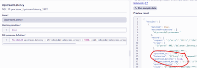

OK, found it, solution is easier then thought 🤣
When not parsing JSON explicitly it's parsed implicitly, with the following DQL
fieldsAdd upstream_latency = if(toDouble(latencies.proxy) < 1000, ceil(toDouble(latencies.proxy) / 100) * 100, else:ceil(toDouble(latencies.proxy) / 1000) * 1000)
The "Run sample data" in open pipeline shows null, however, the metric upstream_latency is available in notebook/dashboard, my mission to create great dashboards from Kong API Gateway logs continues...
