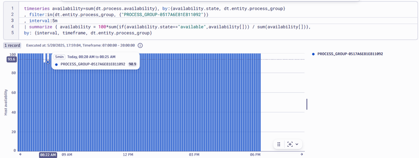

It requires getting all timeseries of availability state for process (in my example for process_group) and then calculating percentage of existence of availability state vs all states.
In my sample case it looks like this:
timeseries availability=sum(dt.process.availability), by:{availability.state, dt.entity.process_group}
, filter:in(dt.entity.process_group, {"PROCESS_GROUP-0517A6E81E811092"})
, interval:5m
| summarize { availability = 100*sum(if(availability.state=="available",availability[])) / sum(availability[])},
by: {interval, timeframe, dt.entity.process_group}

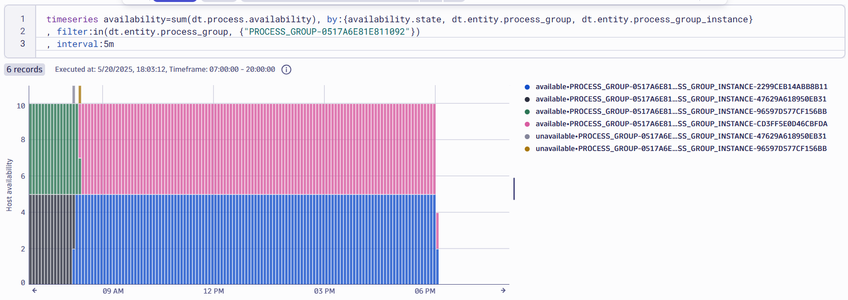

by executing this query you can look at the data behind:
timeseries availability=sum(dt.process.availability), by:{availability.state, dt.entity.process_group, dt.entity.process_group_instance}
, interval:5m
there are 2 PGIs over time and at certain moment 2 of them become unavailable.
