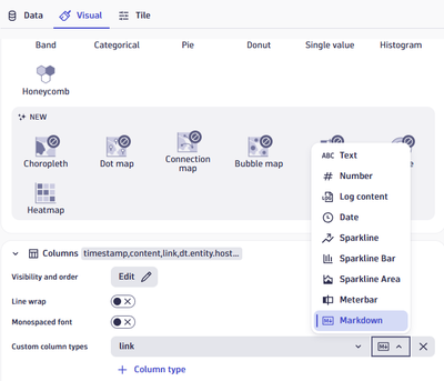

However, one minor hickup remains, in my table it all looks fine but I need the url so that it is clickable and once user click on it it them ut takes them direct to the problem, I am not sure if html is supported inside a table in the dashboard? will check
For that you have to add the link with markdown syntax as in the example submitted by @p_devulapalli and then set the table column type as markdown

It worked like a charm Gerard thanks. it did not know tables can also have markup.
