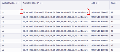

I would like to be able to report on Monthly availability percentage split by Business (06h00-18h00) and Non Business Hours (18h00-06h00) - ideally split at the "timeseries" level
In the screenshot below you can see that "AvailabilityStateUP" contains the array for the WHOLE reporting interval - in this case the last 24 hours - not split by "end()" -   I can filter by "hour" after the timeries extraction but it does not help as the array contains all values for the whole reporting period
The problem is the availability figure for each hour will be the availability % calculation of the WHOLE array for the reporting period
I thought I could split by: end() but this is also not possible
I also looked at "bins:" but the documentation did not help me - is this an option? can someone assit with the syntax as per my requirement
Any other ides? Apprecaite any assistance

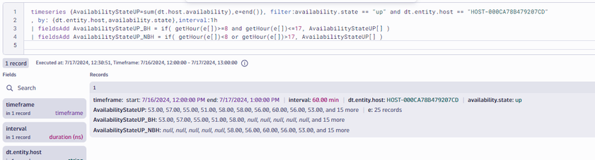

You do not need to expand. You can use iterative expressions:
timeseries {AvailabilityStateUP=sum(dt.host.availability),e=end()}, filter:availability.state == "up" and dt.entity.host == "HOST-000CA78B479207CD"
, by: {dt.entity.host,availability.state},interval:1h
| fieldsAdd AvailabilityStateUP_BH = if( getHour(e[])>=8 and getHour(e[])<=17, AvailabilityStateUP[] )
| fieldsAdd AvailabilityStateUP_NBH = if( getHour(e[])<8 or getHour(e[])>17, AvailabilityStateUP[] )
 this way you get 2 timeseries, each one filled only values in our outside business hours. Then you can proceed with summarization of the array using array functions.

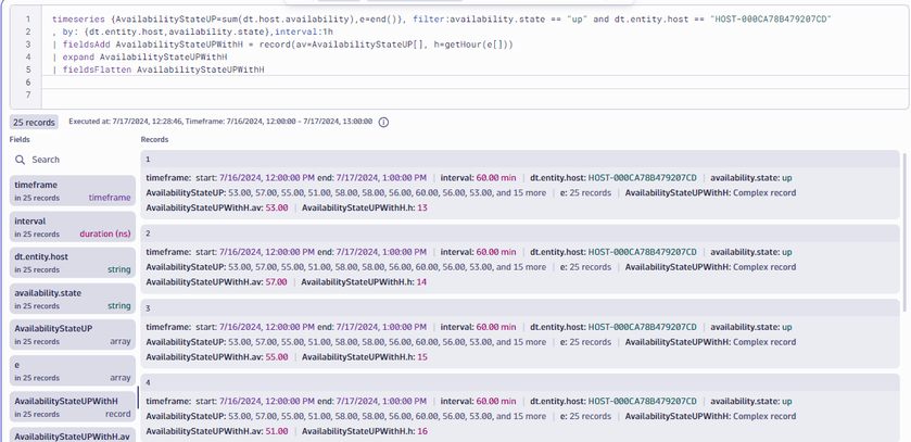

It is possible with expand too, but you need to construct single array of records containing both: availability metric and time:
| fieldsAdd AvailabilityStateUPWithH = record(av=AvailabilityStateUP[], h=getHour(e[]))
| expand AvailabilityStateUPWithH
| fieldsFlatten AvailabilityStateUPWithH
Hi krzysztof_hoja
The iterative expressions solution is perfect - works like a charm
Really appreciate you taking the time to test and provide a solution
