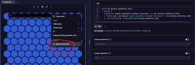

Using DQL you can query entities and then lookup relevant timeseries. When done to create a honeycomb, you can select any of the honeycomb tiles, mouse over the record and then select "Open record with" as shown below.
When you then select "Open record with" it will give you an option to open with relevant apps. In my example I am querying synthetic tests so when I click through it gives me options to view the synthetic in a few different views.
Hope this helps!

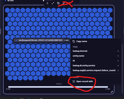

21 Jan 2025 02:02 PM
When I do a simple query for services, I cannot link to the services app. It seems to work for other "apps" but not services.
21 Jan 2025 10:01 PM
It looks like you've selected the "Open with" for the whole DQL tile as those app options tend to show up when doing "Open with" on DQL queries. I have tested it in another environment with a service specific query and it seems to be working. The example query I used is:
fetch dt.entity.service
| lookup [
timeseries avg(dt.service.request.failure_count), by:{dt.entity.service}
], sourceField:id, lookupField:dt.entity.serviceAs seen in the screenshot below, if I click on a hexagon you can then hover over the name of the service bringing up a context menu for that specific record. At the bottom of that there is "Open record with". Don't use the menu at the top of the whole DQL tile as that will give you options for the DQL query within the tile and not the record.
Additionally you can include URLs in the fields returned and that will allow you to click directly through to the URL as seen below. In my example the URL was added statically but you can also dynamically add them using values provided in the query so that each one is different. Just another idea for clickthrough possibilities.
23 Jan 2025 12:48 PM
I swear that was not working for me last week. It is what I was trying to do.... though you are correct in my last test I used the title link to open vs clicking on the hex.
Thank you!
