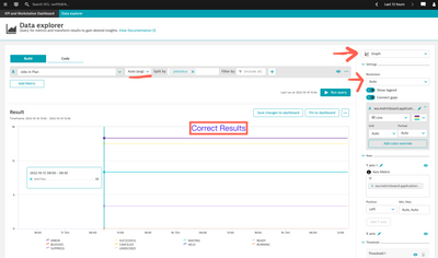

Result: Correct result was observed even though time duration was varied (2 hrs , 6hrs, 24hrs , 72 hrs , 7 days  etc)
Code used is : wa.metric.application_wa_JobsInPlanCount_job:splitBy(jobstatus):sort(value(auto,descending))

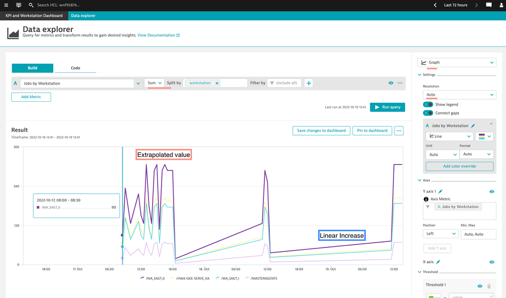

It has two dimenshion keys : "jobstatus" and "workstatus"
Dimension key:  "jobstatus" and "workstation (Only two)
Aggregation:

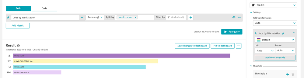

(a) Auto(avg) not working because giving a decimal value for it (which is incorrect).
(b) Sum is giving extrapolated value
  • For short duration - giving twice of the actual count or sometimes other value.
  • For long duration- With the increase in time duration, its value is linearly increasing.
[ have a look to the attached screenshots ]
Kindly, tell me how to avoid these erroneous results.

At the first glance,  all depends on your fold transformation selection.
According your selection, the aggregation Auto(avg) and an Auto fold transformation on the result, the single average values are summed up (same as described here).
You can do the following things:

It is difficult to tell without an idea of the underlying data. It looks like the data is constant over time e.g. this line below:
application_wa_JobsByWorkstation_jobs{jobstatus="WAITING",workstation="/HWA-GKE-SERVE_XA"} 4
 is ingested multiple times with a constant value of 4. In which case the average would be 4 as expected, but the sum with this line
application_wa_JobsByWorkstation_jobs{jobstatus="WAITING",workstation="/WA_SAGT_1"} 2
would lead to 6.
If aggregated over time, then it is expected to increase with coarser resolutions.
What would be the desired output when using the 2nd metric and aggregating over Workstation?
