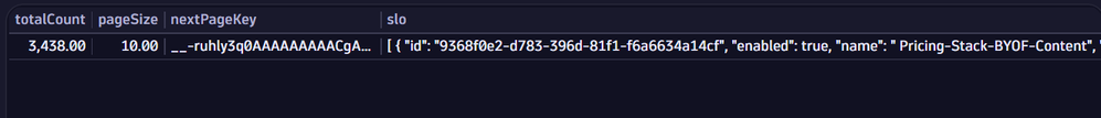

I tested the code you sent, and I changed it to extract the SLOs using the Dynatrace API and you’re right—it returns a table with the API results, and one column contains the information (in my case, it’s called “slo”) when using "return result", as shown below:
Code:
export default async function () {
  const token = 'dt0c01.token';
  const response = await fetch('https://dynatrace.com/e/8436fe7/api/v2/slo', {
  headers: {
    Accept: "application/json",
    Authorization: "Api-Token " + token
  const result = response.json();
  return result;
Result:

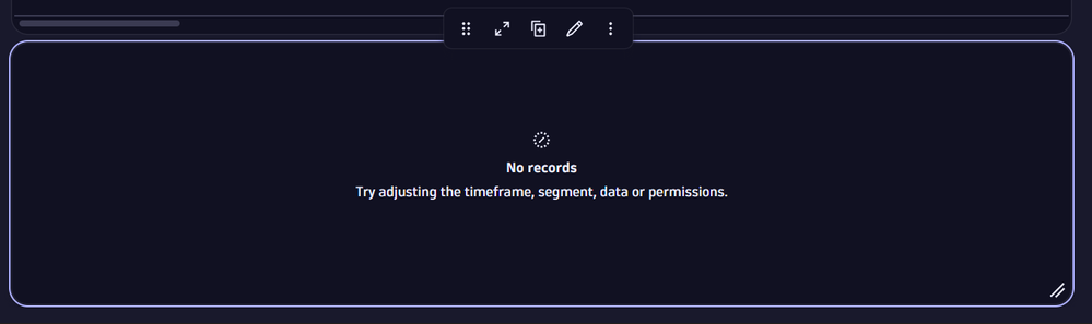

If we try to use return "result.slo", it shows that there’s no data:
Code:
  headers: {
  return result.slo;
Result:
