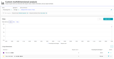

Currently, I have added a tile to my dashboard that shows the total processing time of the key request(s) as an average. However, I'd like to split this tile by an extra dimension of 'flow' (the name of my request attribute). The request attribute doesn't seem to be an option in data explorer when I configure the split:
If I try to split the data at the service level, there does seem to be a filter available for the request attribute, but this doesn't seem to support the value of the attribute. It only seems to refine the query by which requests contain that particular attribute key:
I can seem to get the result I'm looking for using multidimensional analysis, however:

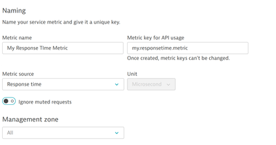

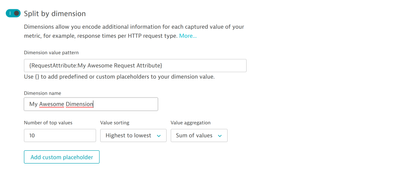

Request attributes are not part of the metric dimensions out of the box. You can create a calculated service metric for the request and add the request attribute in the "Split by dimension" section of the calculated service metric.
07 Jun 2022 05:24 AM
Create calculated metrics | Dynatrace Docs use it as suggested by @mgome , as you said split by service result in data explorer is not bringing you the expected value you can go ahead with calculated metrics

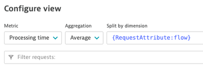

Before I create the calculated service metric, I suppose I could configure the MDA view in one of two ways:

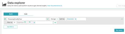

Does the presence of a filter (such as filtering on a specific 'flow' value) in my MDA query/view have an effect on the the calculated service metric that I create? I suppose for my use case, I would not want to apply a filter for a specific value. Idea being that the calculated service metric can be split by dimension in Data Explorer? Something like:
Unfortunately at the time of writing this, I don't have any data to work with... or else I'd test this on my own. Would this data explorer query allow me to filter on specific values for the 'flow' attribute?
08 Jun 2022 05:37 AM
the presence of filter will not have any additional effect on your calculated metric. Ideally data explorer will allow you to filter specific value based on your request attribute.
08 Jun 2022 09:16 PM
Now that I have some data coming in, I can confirm that using the calculated service metric in Data Explorer, I can filter by the value of the request attribute using the 'Dimension' filter. Thanks!:

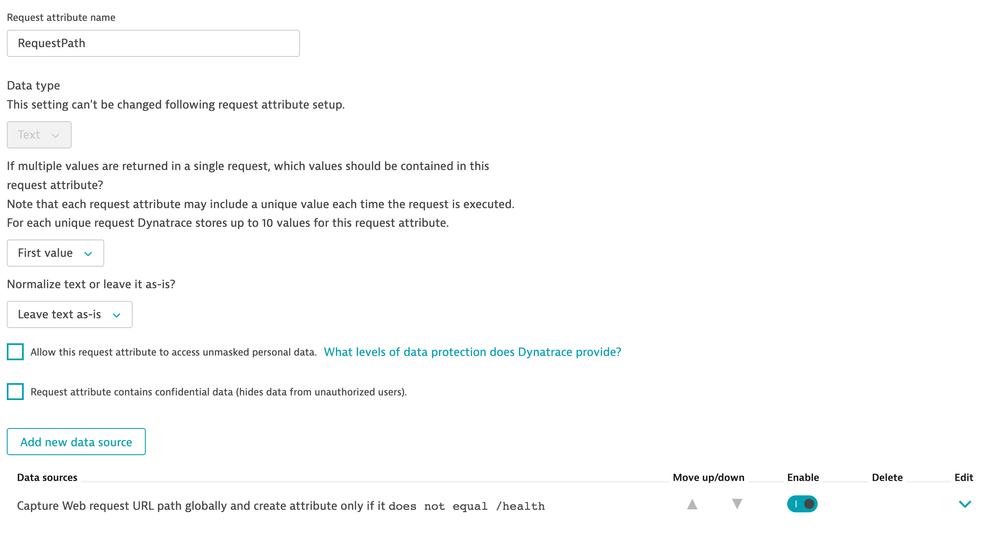

13 Apr 2023 12:07 PM - edited 13 Apr 2023 12:08 PM
Hello,

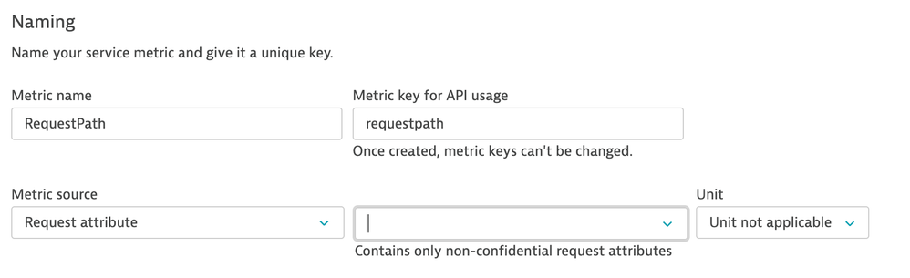

I stumbled over the same issue. I want to filter requests based on the request path in a dashboard. So I created a Request Attribute for the request path, and excluded /health requests (I do not want to chart them).
The request attribute works fine: It is added for /api/* requests, but not for /health requests.
However, the Request Attribute filter in Data Explorer is totaly useless, it does not even filter out those requests which do not have the Request Attribute. Moreover, I cannot create a calculated service metric, because the request Attribute selector is empty.
Can someone help or explain why it's not working as expected?
Best regards
Clemens
17 Apr 2023 08:34 PM
You are not defining the calculated metric correctly.
