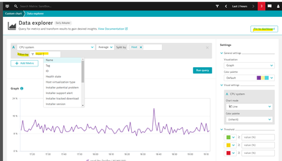

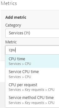

We need look Service CPU Usage % on dashboard
It metric available on Detailed CPU consumption page
How I can add it to Custom chart ?
19 Apr 2021 05:16 PM - edited 19 Apr 2021 05:17 PM
Hi @MAkimov
You can filter the metric builtin:host.cpu.system with host you are looking for and then pin it to the dashboard
HTH
Yos

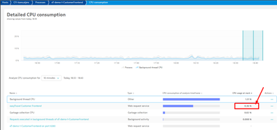

Hello @Yosi_Neuman
I do not need host.cpu.system !
I need service CPU usage %
Metric which you can see on my screen for Detailed CPU consumption
Fot example for easyTravell Customer frontend

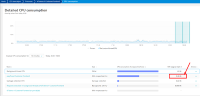

20 Apr 2021 09:25 AM
Hello @andre_vdveen
It is CPU time. We understand it metric
But we want have metric service CPU usage % on dashboard
see my screen

Not sure if it helps, but your screenshot has Processes CPU Consumption, not Services.
Processes CPU consumption (and other metrics per Process) can be found under Technologies > Generic > CPU (or just put builtin:tech.generic.cpu.usage im Metric field)

The Screen shot that was provided does indeed show the services. The view point is looking at a specific process, and the services running on that process. If the User were to click on 'easytravel customer frontend' that would transport them to the selected service.
08 Jun 2021 01:31 PM
@MAkimov There isn't a way to target the CPU consumption of a Service as a dashboard Tile/Chart. You can tile/Chart the next level down which would be done by marking things as Key Requests. Keep in mind, marking key requests are always forward facing.
I would recommend putting in a RFE as the functionality that you are looking for does not exist in the product as of today from a dashboard view point.
As a work around, you can use a mark down tile and drop a link to the page that you want to access. But even then it wont show you values on the dashboard, rather just quick and easy access to the page.

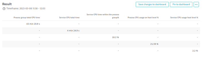

Last column is the above mentioned metric expression:
3rd column came from the first two with a % calculation, then I counted the 10,2% of the 21,59% which is the fifth column.

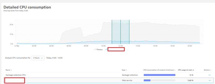

The above calculated process CPU detailed breakdown with the test service below. I know that 2,68 % is not 2,2% but it is quite close. I have tested it with randomly and the results are really quite close the CPU detailed breakdown values:
