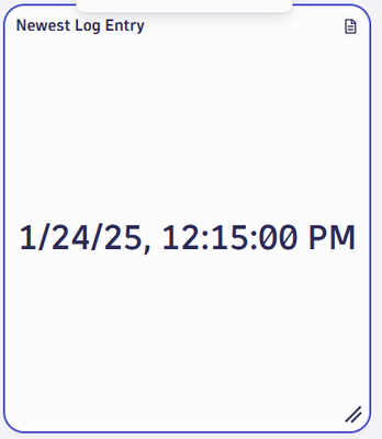

I've created a panel that pulls this information via the following DQL into a single value panel -
fetch logs
| filter //some filter criteria
| summarize max_timestamp = max(timestamp)
This shows up as the following panel in the dashboard.

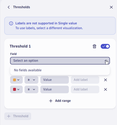

Now, in order to highlight the text in red if the date is less than today's date, I went to the thresholds but could not find a way to select the variable to set this.
How can I set a threshold for the timestamp value to show up in red color if it's older than today's date?

Unfortunately it doesn't look like this is possible at the moment. It would be great to see that so it would be a good suggestion for the ideas section of the forum. In the meantime you could evaluate the log in the query like I have done below and then show a string true/false (or any string). And then you can set thresholds on strings.
Couldn't find a way to include the timestamp in a single value along with the true/false since it is a single value. You could also play around with using a table but it wont be as aesthetic.
