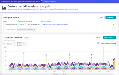

You can apply the Exception Count measure on the dashboard with Spliting Mode: Service and Spliting by dimension: {Exception:Class} enabled. Please remember that you should to create a new measure. Then you create a new measure and add it to the tile you have pinned to your Dashboard.

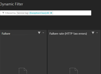

I want to do something like this and then get the results exactly like the page you and I get inside.
I want to perform the search and get the data already in the filter of the dashboard
11 Apr 2023 07:43 AM

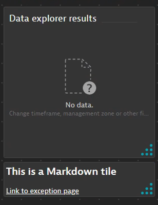

For exceptions, you won't do it that way. You can put the metric on a separate tile. Then underneath you can add a Markdown tile - you will add in it a link to your Multidimentional View with the appropriate filter.
Radek

11 Apr 2023 07:54 AM

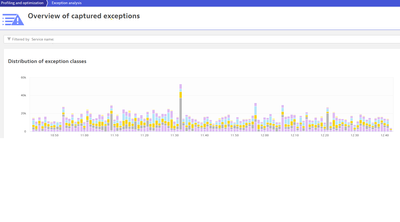

I also saw this option
Overview of captured exceptions
Is it possible to add the option to the dashboard?
11 Apr 2023 08:26 AM - edited 11 Apr 2023 08:27 AM
Hey,

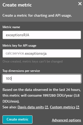

I got confused and you can use filter: Exception: Any exception. However, remember the limit on the number of dimensions for calculated metrics "This exceeds the limit of 100 services for creating calculated service metric."
In the first step, you need to create a multidimentional view:
*Remember to select the appropriate Management Zone.
In the next step you choose Create Metric (remember the limit mentioned above).
Once the metric is created, you pin it to the dashboard of your choice (The metric collects data from the moment it is created - there will be no historical data in it)
Then under the metrics tile you add a second tile with a link to Multidimentional where you have the appropriate filter. You have to know that this metric will consume DDU's.
Sorry for the confusion with this filter:) It slipped my mind:)
Radek

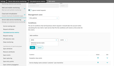

13 Apr 2023 11:35 AM - edited 13 Apr 2023 11:37 AM

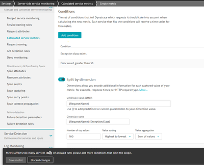

First of all, I thank you for the help, and the answer is fast, but I don't need to produce what you wrote
I'm also trying to get a new metric but it doesn't allow me to hit the top 100 or top 10 of Serveries
Another example of I want to produce in the dashboard is like the image below
Try to restrict down the data - because you are limited to a maximum of 100 services.
13 Apr 2023 11:39 AM
How can I do this according to any metric
13 Apr 2023 02:18 PM
You can add new Condition to this metric to narrow the data.

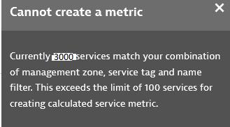

16 Apr 2023 08:54 AM
I appreciate your help,
I managed to download the numbers of the service But still couldn't reach 100.
It's just that there are a lot of Services in the system in the same area, and there's a lot in common in their names, so it's not easy to tell them apart,
Is it possible to do the TOP 100?
18 Apr 2023 09:24 AM
https://www.dynatrace.com/support/help/observe-and-explore/metrics/built-in-metrics#services
What can I do if these metrics limit what I need?
For every condition I register by name and server marking, I reach more than 100 servers, so I can't create metrics.
08 May 2023 12:22 PM
Can anyone give an answer on this??
08 May 2023 09:48 PM
Hi @yuval1983
As mentioned within SSL Cheeker extension under Calculated metrics "The default limit is currently 100 so it might need to be increased to 1000 via Dynatrace One ( serviceMetricsMaxAffectedServiceLimit )."
Try to connect with DT one (via in product chat or open a support ticket) and ask to increase this limit.
HTH
Yos
