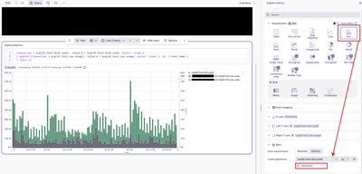

You can still achieve this but there will be nuances based on the dimension you use when you split the metric.
If you Have selected the bar chart you'll super impose bar to all.
Once you understand what is meaning full to have as line you can further click on "bars" and add (+) custom Geometry.
Please test it and see if it is fitting your use case 😀
Regards
I have tried with your suggestion and it works as expected.
Thank you for your help 😄
