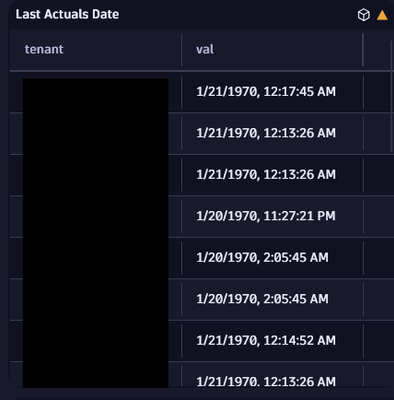

For example, this query functions but jumbles our dates (avg/max/min/count/sum):
timeseries last_run_date_gauge = max(last_run_date_gauge ), by: { tenant }
| fieldsAdd arr = `last_run_date_gauge`
| fieldsAdd val = timestampFromUnixMillis(arrayLast(arr))
but this query doesn't work at all, as an aggregation is required:
timeseries last_run_date_gauge = last_run_date_gauge , by: { tenant }
Ideally it would be as simple as `timestampFromUnixMillis(Last(last_run_date_gauge)), by: { tenant }` ?
Am I missing something simple where we can display this data in a way that it doesn't lose it's meaning?

These are the dates we are seeing with the max query:
timeseries date_gauge = max(date_gauge ), by: { tenant }
| fieldsAdd arr = `date_gauge`

This is what is in Dynatrace:
{"records": [
{"timeframe": {
"start": "2025-08-03T11:10:00.000000000-06:00",
"end": "2025-08-04T11:20:00.000000000-06:00"},
"interval": "600000000000",
"tenant": "<Rd> PROD",
"date_gauge": [
1754179200,
1754179200,
1754179200,
{"timeframe": {
"date_gauge": [
1754006400,
1754006400,
1754006400,
The raw data is being changed, is this a constraint in metric size?

It looks like your query does not match your data dimensions. You are selecting the maximum by tenant , while in Grafana you have also environment, instance and job too. In this case, Dynatrace returns maximum of the value from the interval for each tenant.
Can you share a piece of the raw data? (Prometheus exporter sample from your environment)
I can't share the raw prometheus data, but adding a *1000 and also filtering by env (the job and instance are the same for all metrics) seems to have fixed that particular graph. However we are still getting aggregated data on our status codes. And if Dynatrace aggregates data on injest then we will simply have to live with what we've done below with 'close enough' data and go back to manual checks for our on calls:
