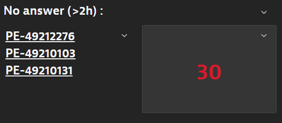

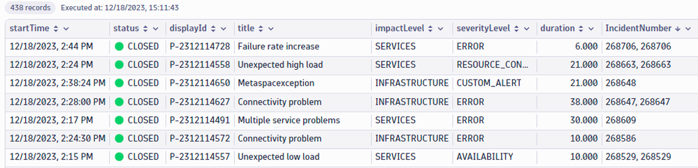

This is very interesting task. I think you need to create Custom Dashboard and Custom script. Customize what you exactly you want by you ownself. We have some similar tasks and solution below.
First - Dynatrace have problem API. With additional script you can easly get problems open problems, open problems without comments or some type as you need.
Then push back this information for your own customized Dashboard.
For example -We have list of tickets without answers - in our internal CRM System.
Using a custom script on a python - we take this information from internal CRM system and change the dashboard using APIs ( dashboard API ) and tile ( markdown )
This is how it is look like:
