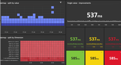

The answer to your question is: "RAG status for Apdex dashboard tile"
single value tiles => background color, thresholds for states as well as heatmaps (state over time)
Configure and use a heatmap visualization in Dynatrace
https://www.dynatrace.com/support/help/how-to-use-dynatrace/dashboards-and-charts/charts-and-tiles/v...
Configure and use a single-value visualization in Dynatrace
https://www.dynatrace.com/support/help/shortlink/visualization-single-value

Is this what you're looking for? https://docs.dynatrace.com/docs/observe-and-explore/dashboards-classic/charts-and-tiles/visualizatio...
