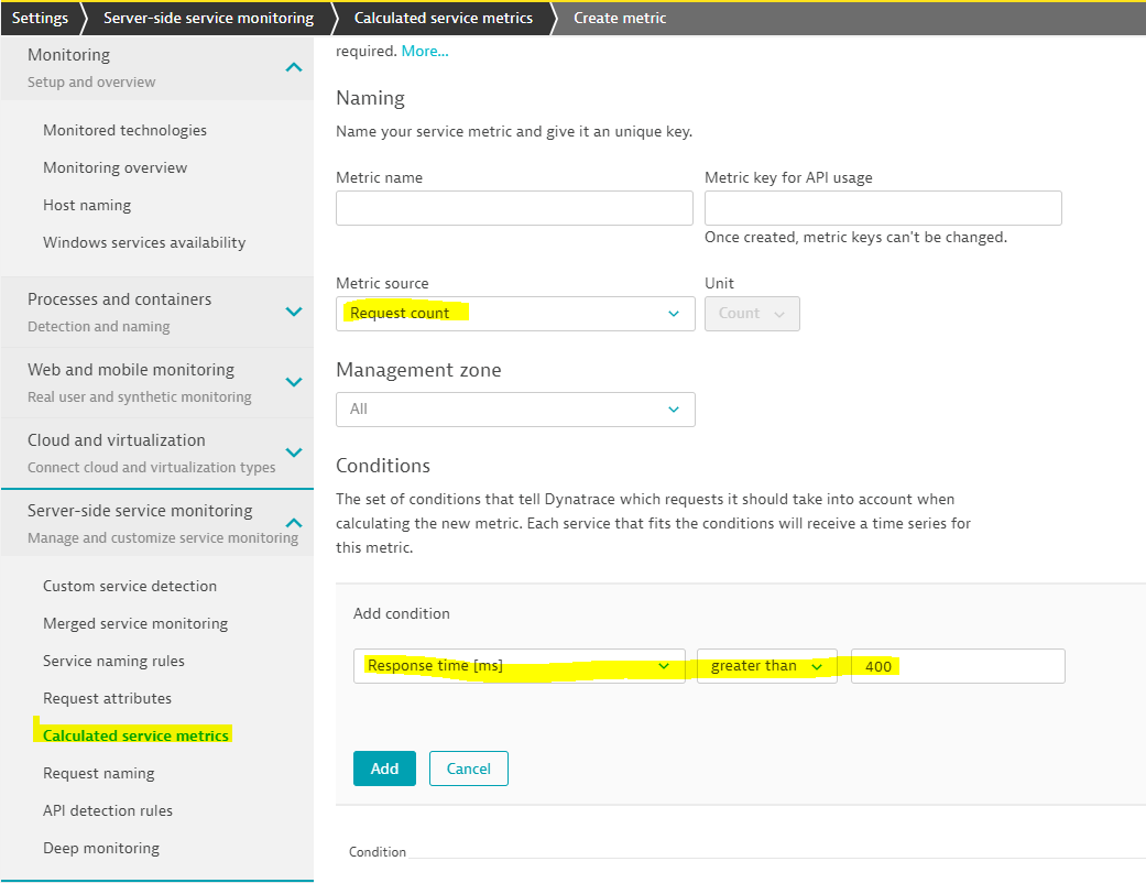

HI,
I would like to check the count of slow (over 400ms) service request and display it on the chart of dashboard.
How do I create this metric on Dynatrace? (AppMon could get this slow count setting.) Does anyone have the sample setting?

Create a calculated service metric and as a condition add one for your response time. You can also filter it down to the services of interest if needed:

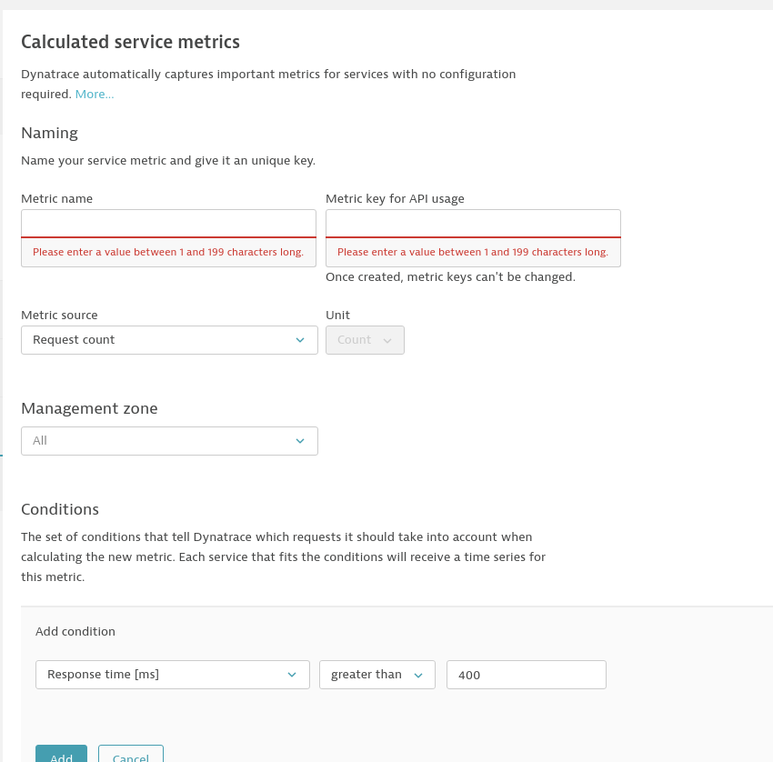

You would have to define a calculated service metric for this.
Also, add more conditions so that it only matches on the services you're interested in (service name being one condition you could use for example). Otherwise, every single service in your environment would get a timeseries for this metric.

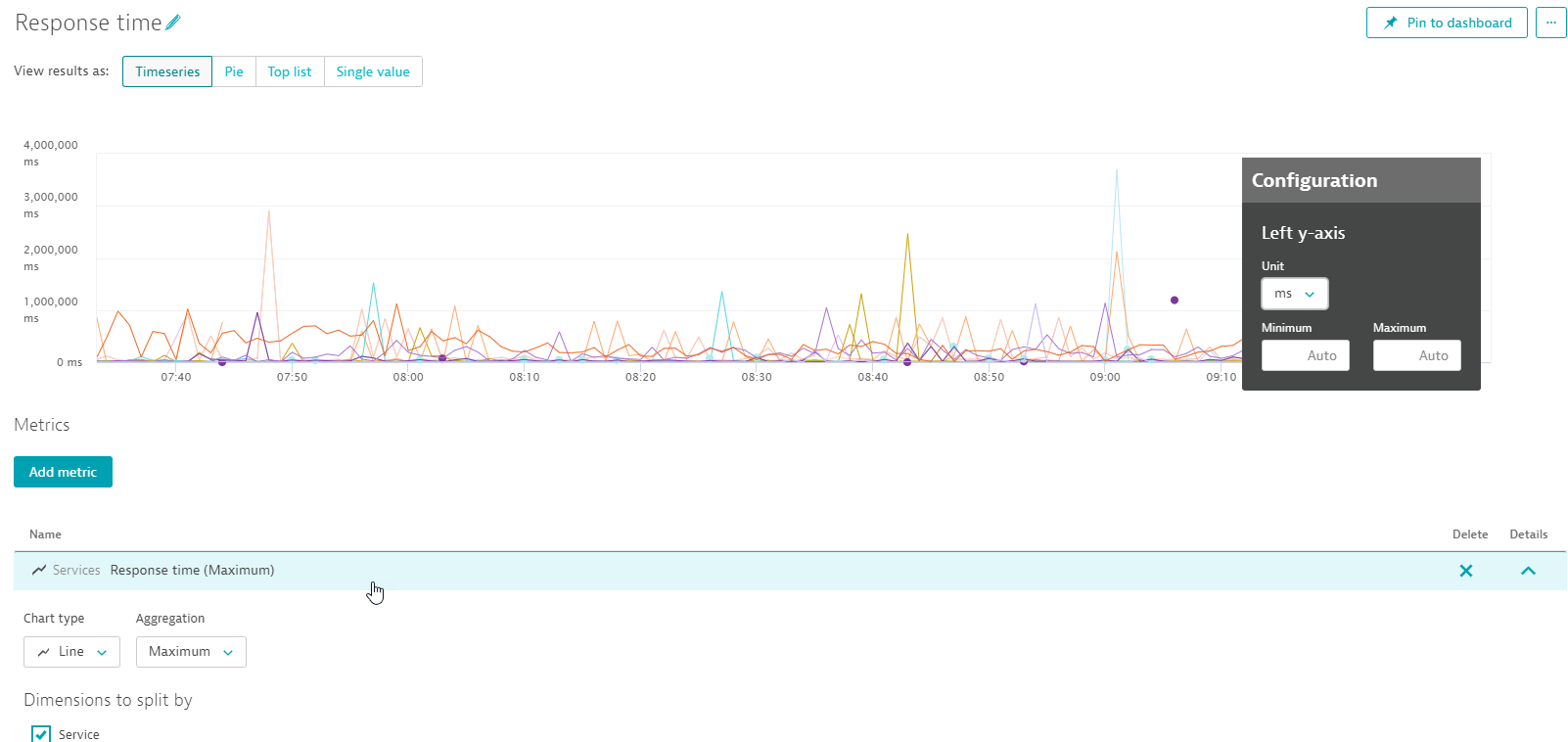

You can create a custom chart but you cannot set the max to see anything above 400ms:

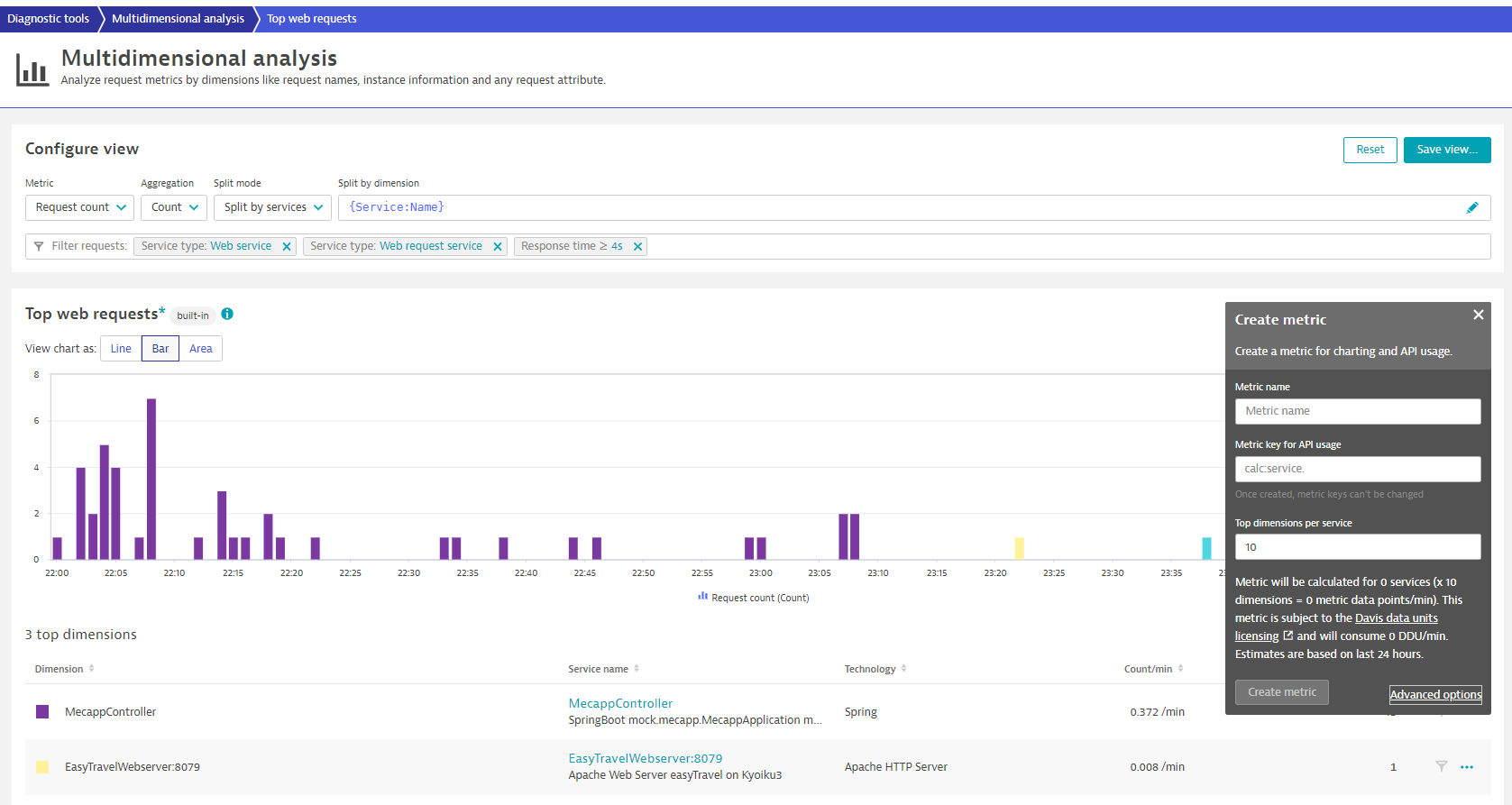

 I understand the setting of the metric. And I found the metric can set from Multidimensional analysis.
