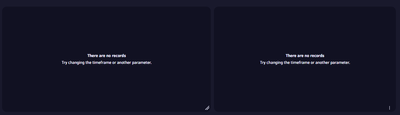

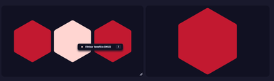

I've included an example of what I need to do. In this case, the idea is that all flows appear on the tile, even if there is no open issue. So all the steps would be green and if an alert were to open, red. But I can't think of a way to do this, to make them all visible, even without an open issue.
With closed problems
No open problems
