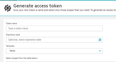

Idk if this is the answer that you want but you can set the date of expiration token
API Tokens are different but thanks for the reply.
