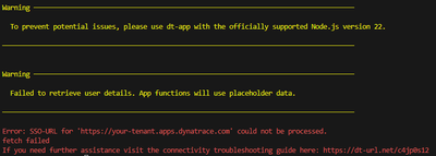

One more thing if I may ask: we completed all the checks in the troubleshooting connectivity page of the documentation: Troubleshoot connectivity | Dynatrace Developer  , so all the connection tests work as expected, both for connectivity regarding our machine and for node.js.
However, when we start the app, the SSO-URL seems to be not reachable.giovannialb_1-1744891827534.png
We set up also NODE_EXTRA_CA_CERTS  as local variable and updated the npm configuration:
$env:NODE_EXTRA_CA_CERTS=path\to\certificate.pem
npm config set cafile "path\to\certificate.pem"
but it seems not to work.
Do you have any insight on this?
Thank you very much

These are app logs after we performed the command npx dt-app dev:
2025-04-18T10:33:53.911Z DEBUG [AUTH] Retrieving SSO-URL for environment 'https://{environmentid}.apps.dynatrace.com'
2025-04-18T10:33:53.911Z DEBUG [HTTP(S)] Execute GET request without allowing redirection to 'https://{environmentid}.apps.dynatrace.com/platform/oauth2/authorization/dynatrace-sso'
2025-04-18T10:33:54.000Z DEBUG [AUTH] SSO-URL for 'https://{environmentid}.apps.dynatrace.com' could not be processed.
2025-04-18T10:33:54.000Z DEBUG [AUTH] Error: fetch failed
2025-04-18T10:33:54.002Z ERROR Error: SSO-URL for 'https://{environmentid}.apps.dynatrace.com' could not be processed.
fetch failed
It might be worth checking your firewall settings if the proxy isn't resolving the issue. It's possible that the dt-app CLI is an unknown application, and access to the network/internet is being blocked.
I recommend discussing this further with your IT department. For additional guidance, please contact Dynatrace support, as this issue may require a more detailed investigation: https://one.dynatrace.com/hc/en-us/requests
